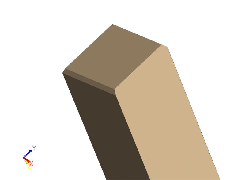

Are you talking about making a chamfered top leg like this?
Chamfered Leg.jpg (21.45 KiB) Viewed 24788 times

Same concept...just create a tool of the appropriate angle (no diameter when you create the tool) and apply it to the top of a display cube.
I made my display cube 2 inches wide, 2 inches long and 36 inches deep. You can use a display board but you would have to create it so it the thickness is actually the desired length. When you add the board the length would be the same as the width.
Using the same 2x2x36 example, your display board material would be 2" long and 36" thick. When you add it the width would be 2" to give you a top view of a 2x2x36.
Then all you do is apply the tool to the perimeter using "chain" as you already have.

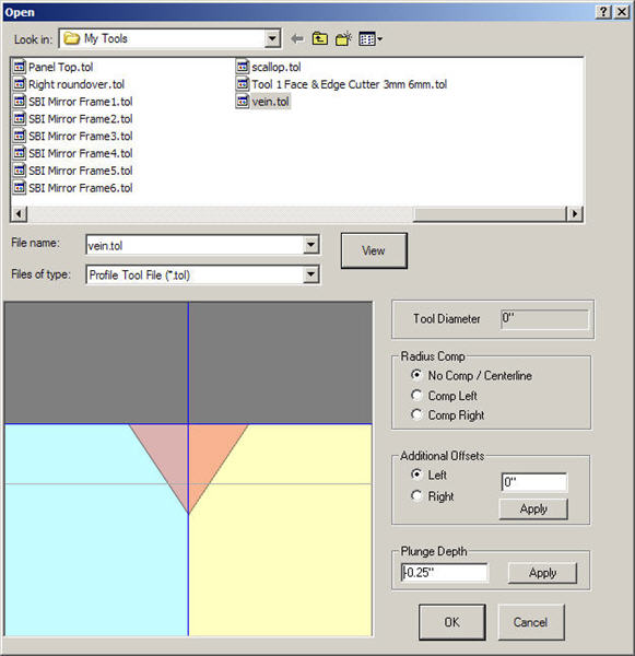

The tool that I created was a "v" bit that has the pont of the "V" on the 0,0 point in shape manager. It was then drawn from 0,0 to -13/16,1/8 for the left side of the bit. Then it went from 0,0 to 13/16,1/8 for the right side of the bit. finally a line was drawn from -13/16,1/8 to 13/16,1/8 completing the "v" shape. I then saved off the tool as having no diameter and applied it to a board that was 51" thick, 1 5/8 wide by 1 5/8 long. Set the plunge depth to -1/8. Same crappy error message. I've redrawn the tool with the point of the V at -1/8 and set the plunge depth to 0. Same crappy result. I have been able to perform the routing operation with any stock amana or cmt shape, just not my own. What the .......Frustrating!

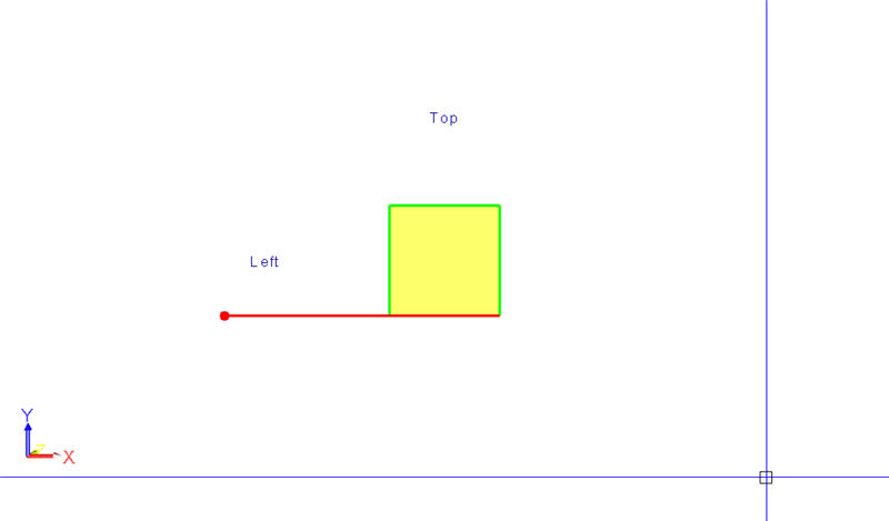

Re: Shape manager retard
It sounds like what is happening to you is that the tool is overlapping on the top center. Make the point of the "V" lust a bit left of 0,0 and make sure the tool is wide enough on the right side to cut to the edge.
I ran into the same error when using the tool set exactly at 0,0 so I offset it left 1/16" and you can see that it left a lip around the edge. It would not have done this is it were wider.
The tool does not have to be "V" shaped unless you use it to cut a groove. All you need is the right side to cut a pattern like this. Kerry Fullington said it this way: "This of the tool as a scraper instead of a rotating router bit."
Once you have the part shaped like you want, export it (select the part, click "File" on the menu then click "Export Selection" on the menu) and texture it in the Display Part Editor.

I went ahead and re drew the right hand side of the "v" bit and started the tip at -1/64,0. I then drew the right side 13/16+1/64,1/8. Depth was set at -1/8". The result was a 1/64 wide, 1/8" deep rabbit at the top of the leg going all the way around. This occurred if the chain moved from L-R or R-L. I would send you an image of the result but don't know how to do that yet. Any thoughts?

O.K. I just figured it out. The first "one sided" tool bit that I attempted after your instructions were cutting just the 1/64", to the left of 0,0, off my part ( in my defense, I stated that I was a shape manager retard, though). I figured why not try and draw the wing cutter to the left of 0,0 and see if that will get the chamfer on the leg. BINGO! So there is a disconnect between me and the software over how the cutter is behaving. I'm trying to relate it to a router bit and if i'm moving the bit, the direction of bit movement (the chain direction) would be the Z axis of the x,y,z, coordinates. If the material is on the left of Z then it would be logical (not saying correct) that the cutter (or scraper as you mentioned) should be drawn to the left of Y in shape manager. Yet that does not seem to be the case. I will open the ZIP'ed instructions and see if there are any hints as to what the software is thinking. I re-read the manual a number of times and am still missing it.
