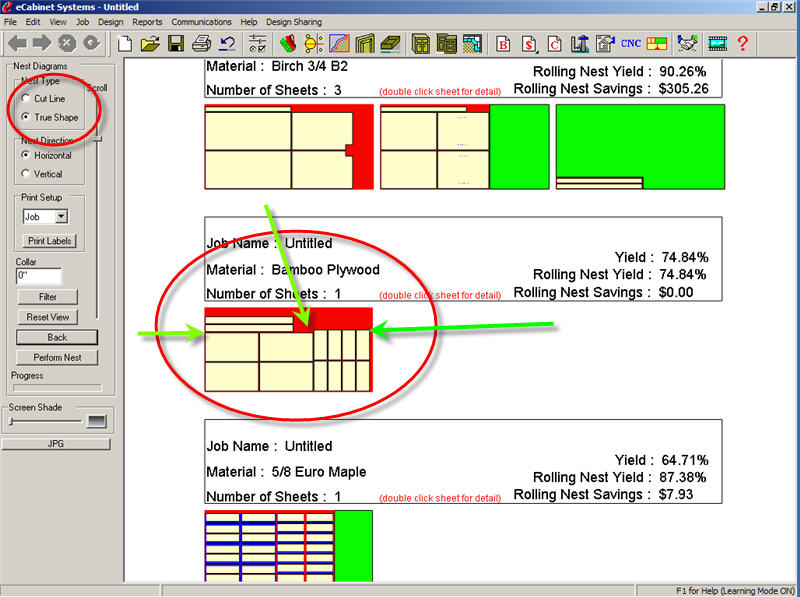

It nest one sheet for me Leo...compare your nest settings to mine below.

Re: Nest Question/Problem
For some reason, the bamboo did not have grain when automatically added. I changed that and got the grain to nest correctly.
Here is the problem...when nesting using cut line, the nest must have unobstructed cut lines across the sheet, either horizontally or vertically. When set to vertical, the drawer fronts will not fit on the remaining material on the first sheet.
Change it to horizontal and then the two toe pieces won't fit.
If you change to True Shape it will nest using a single sheet but the toes are jammed up against the other parts and do not leave an unobstructed cut line. If you are cutting on a CNC you want to use true shape anyway. If you are using a panel saw or table saw, you might still be able to get all of the parts from a single sheet using the true shape nest.

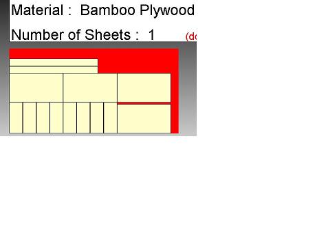

Leo
Is this the nest you are looking for? Please let me know if it is and I can tell you how I did it.

Leo
What I did was remove your mdf drawers and added slab drawers. Then once back in the cabinet editor I right clicked and group parts. Each cabinet I grouped all the drawers. then when I nested them it would nest them all in order like my jpeg. If you have any trouble with this please give me a call.
I tried that but I also grouped the doors which made the same nest.

Dan and Leo
I also changed the tool size for the outline operations.
Justin
I got it to nest the same as you did by removing the double dors from the group. I didn't change anything else, tool size or otherwise...except for changing to slab doors.
