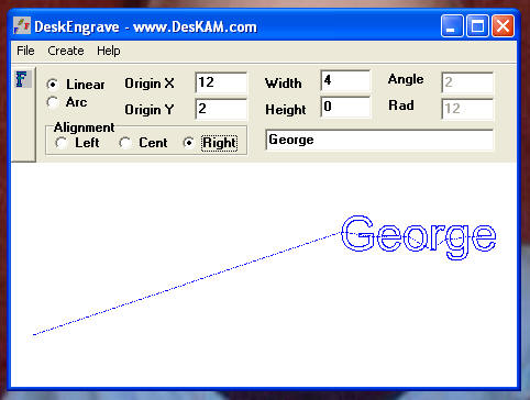

I don't know if this will help you or not Neville. http://www.deskam.com/deskengrave.html

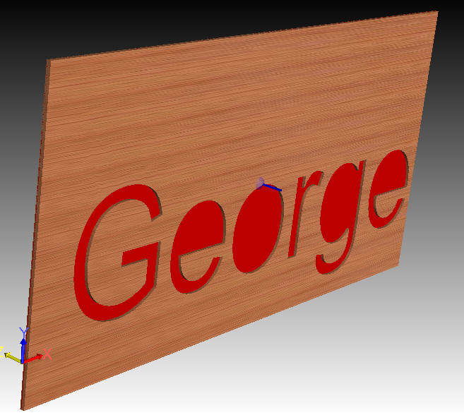

Has anybody used this software for lettering. It looks like a good program, however once the letter files are saved as a DXF file I can't open it with our CAD software (AutoSketch). I tried to send the DXF file to the CNC and it said the material thickness needed to be 0.000 so I thought I would enter a material with this thickness and then change the Z shift, but the Control Nesting won't let you enter a material with no thickness. I tried to open the DXF file in the part editor and then make the necessary adjustments so it wouldn't cut out the complete O etc... but the DXF file had been set up to a depth of 5/16" so I couldn't trim any lines I entered in the part editor. The program won't let you set up a DXF file with a zero depth either. Is it time to upgrade our CAD software or is there something I'm missing?

Rick that works good
This is a 4' x 8' sheet

You can get this done in the system today. For letters like A and B and numbers like 0, you have to divide the letter in half. For example 0, you divide it in half vertically and cut out each half of the 0 separately to achieve what you want.
While splitting the letters that cause islands will give you the graphical look correctly, it will not machine correctly at this time. You will need to make your split pieces cut at a small difference in depth like 0.03mm. Hopefully this amount will not cause you undesired results. The current version of eCabinetSystems will not recognize the islands created when it creates data for CNC. We do plan to implement this in the future, but it is not planned for V6 release.

I have used DeskEngrave many times. Althought it is a basic lettering program, it has always done what I have needed. That is, making DXF files with a variety of different fonts and importing them into contour mode of part editor.

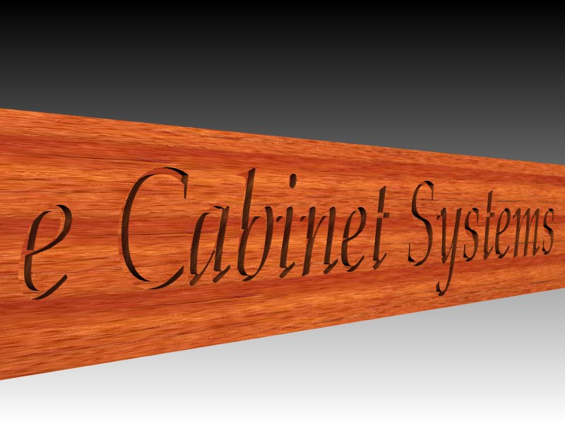

Re: Alphabet
eCabinet Systems
