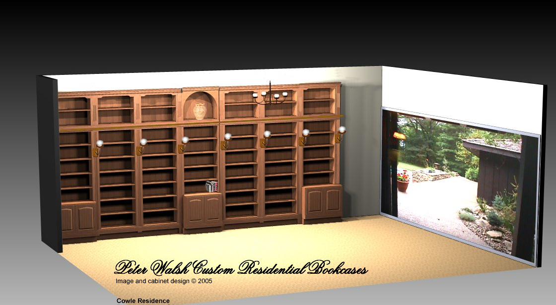

I am a new user of eCabinet and this is the first job I did entirely on eCab. E-mailed the quotation and rendering jpg I created in eCab, and had an order 20 minutes later by return e-mail. Amazing.
Did scare out some bugs in the program I hope to see fixed in future versions. To lay up the cabinets in the room layout, I created vertical assemblies for each section, stacking the cabinets designed for the job and adding the pilasters and trim. Easier than putting 17 or 18 cabinets separately. I discovered when I attempted to nest that the program wouldn't number the cabinets because they are in assemblies. That's a bug and they now know about it. Makes it a little cranky to sort out the parts after cutting but most cabs are the same per assy so not too much of a hassle.
The Sconces I created in MacroMedia Fireworks along with the titles.
Sure wish eCab had lots more \"stl\" furniture images. Anyone know where I can get more 3d images to add to the repetoire?

Peter, have you looked in the Customer 3D Files section of this forum? LOTS of neat stuff there.
As for the numbering of assemblies, they are numbered, just slightly differently. If you have 2 cabinets and 2 assemblies in a room, with each assembly comprised of 2 cabinets, then on the cutlist and nest diagram the standard cabinets will be numbered 1 and 2, and the assemblies will be Assembly 1 Cabinet 1 (A1C1), Assembly 1 Cabinet 2 (A1C2), and so forth (A2C1 and A2C2). I've not yet had a problem with assemblies not being numbered this way. The only place that assemblies don't show numbers is in the Line Drawing Editor... hopefully they will in the next version!
And that's a great looking rendering!

Jeremy,
Thanks for the reply. The numbering problem was in the drawing editor. I neglected to mention that. I wanted the numbers to appear in a face view of the whole library but of course, it wouldn't do that for me as I wrote.
The printouts of the nesting drawings do list parts by individual numbers as you say and that will suffice for now.
I definitely will check out the 3D section. I haven't been out there in a few months. Thanks

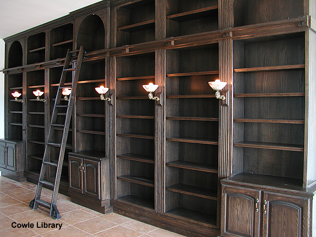

I finally got around to posting the finished library. Tricky to photograph since the customer wanted a very dark stain, but here it is.
Peter

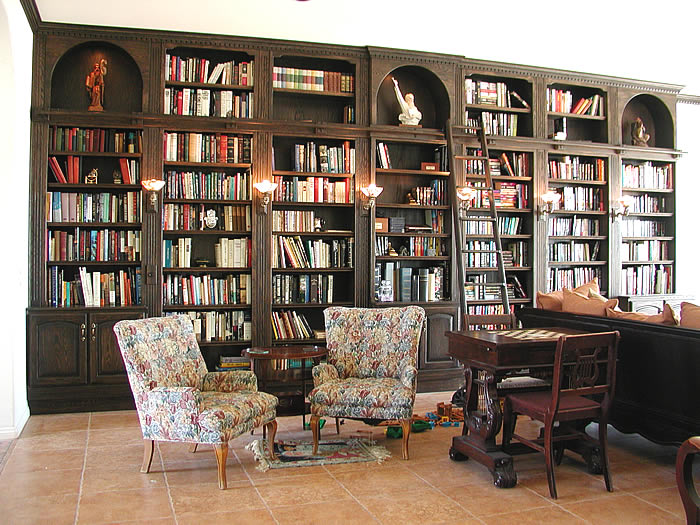

Here is a pix of the finished library with all the books and artiufacts placed on the shelves. Makes quite a difference. Well, that finishes this project. On to the next.

Brian Shannon
Posts: 979
Location: Los Alamos, CA
Post by Brian Shannon »
Very nice work Peter. That's something to be proud of.It's always fun to see the finished product.
Peter Walsh
Posts: 460
Location: Palm Springs, Ca
Post by Peter Walsh »
Thanks Brian,
It turned out nicely, the client is happy, and I got paid. That's three good things in a row. Nice when that happens. I start cutting for the next one (in cherry) Monday.
