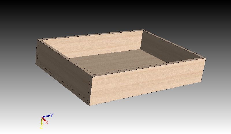

jerry johnson
Posts: 90
Re: Drawer Assembly Techniques
Post by jerry johnson »
Hey guys, here is my standard drawer box with blind mortise and tennon constructin. It requires no flip ops and assembly is very fast. I use pre finished nine ply maple plywood. The boxes are clean and strong. 8)
