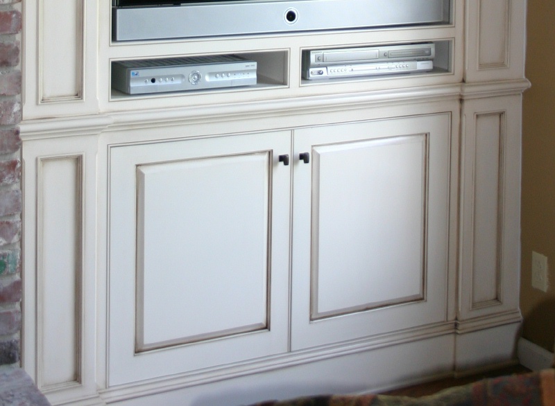

You can do it either way depending on your comfort zone. If it is a stain grade cabinet, you can pin nail the bead on as you described and you will not notice the seam as much. If it is a painted cabinet, the seam shows up more and will require caulking. Glaze the cabinet as well and you can cover or mask the seam.
I personally like to route the bead onto the rail and style all in one piece. Depending on the type of hinge hardware you are using for your inset doors, the bead can interfere with the mounting hardware and separate from the rail and style.

The bead was applied to the rails and styles on this particular cabinet. Since it was getting glazed, I don't mind adding the bead to the cabinet.
