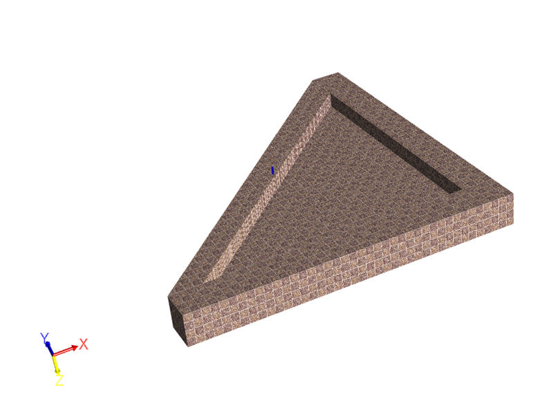

Here is a sample of what I think you are trying to do. I used a Display Cube with the image (one of the standard stone tile images) set to 20 rows and 20 columns then edited it in the Part Editor.

So can I take the shower pan I made from the room to the display part editor and change the image? What you did is what I want it to look like maybe a little darker tile
Ok I get it, forget what the line above says. I have to make a new base out of a cube then take it and make all mthe cuts in the part editor.
Re: Adding a new image
Yep (to the 2nd part). When you add the image to the Display Cube, experiment with the number of rows and columns instead of using "auto" to get the desired look.
