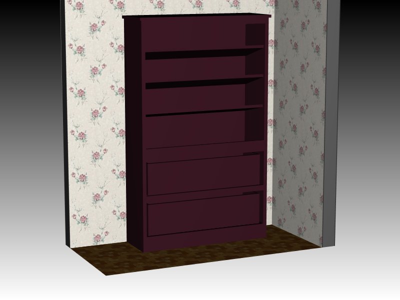

I am trying to figure out how to add doors to this cabinet. I tried applying doors but I can't them the same color as the cabinet. I tried to make a new door as well but can't get the color I want. Any suggestions? I need the doors to go all the way, top to bottom.

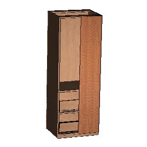

When you add doors just increase the length in the construction settings.I took a Standard Base Frameless and added some fixed shelves and drawers, then added doors with the bottom of the door increased in length.HTH

If you use "Build in house" when you select the default door you can match texture to the cabinet after you add the doors.
