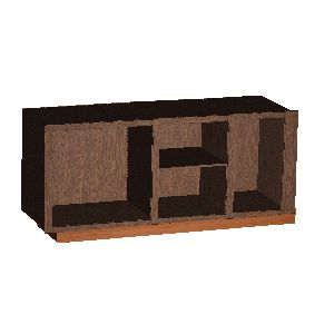

Hi.
This attached assembly is showing 36 1/2" high when it's placed in the room. By all accounts is should be only 36" high. I have it sitting right next to a slightly different assembly that IS 36" high and also measures that too. When I look at them both rendered, they appear to be exactly in line with each other. When I take this assembly into the line editor it also measures 36" in total height (5" toe plus 31" cabinet).
The only problem I see is when I float my mouse over it in the room the popup window says that it is 36 1/2".
This makes me nervous.
Can you look at this and see if there is an issue with it?
Adam
Assembly 1.jpg (9.19 KiB) Viewed 2300 times
Assembly 1.esa
(772.02 KiB) Downloaded 300 times

I brought the cabinet into the assemble editor and custom layout and they show 36" total height.
In measuring in the line drawing editor i still get 36".
I'm unsure why you are getting 36.5".
I am running Version 5.2 Build 5.
