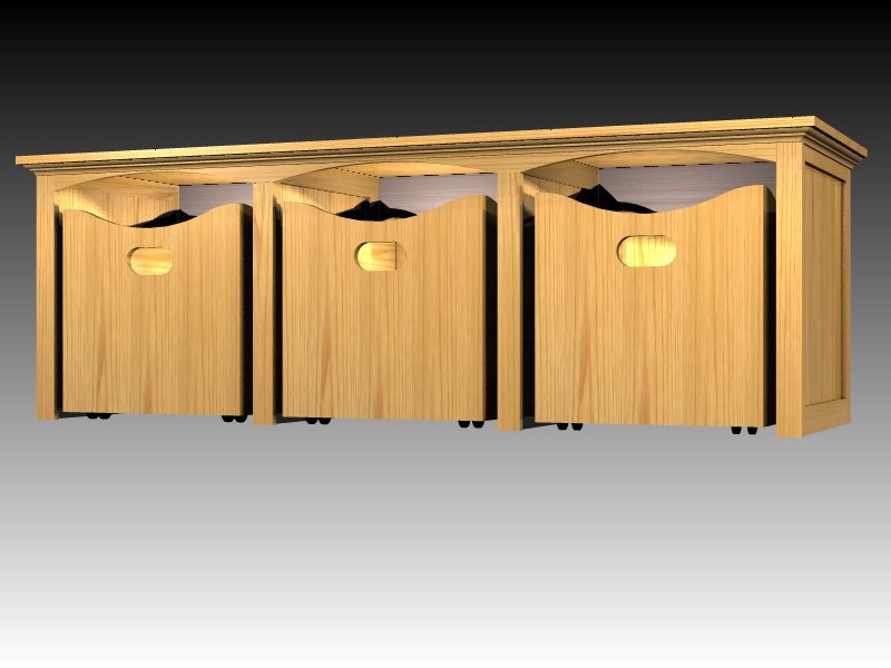

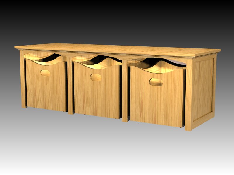

Toy Box Cab with 3-roll arounds under Cab
Toy Box Cab with 3-roll around under Cab
3-19 x 19 x 23 Deep with wheels
The Cabinet is in the ZIP
Frank! You do know you will have to put the toys back in the toy boxs after the kids are done with them :!:

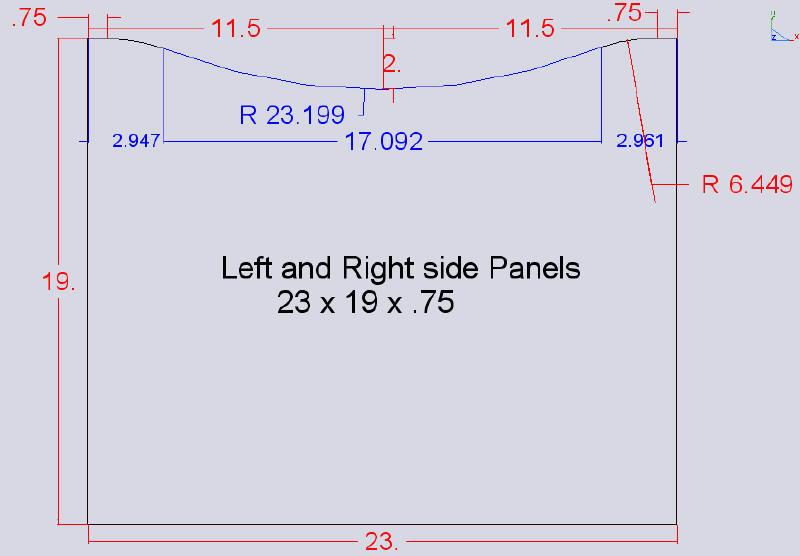

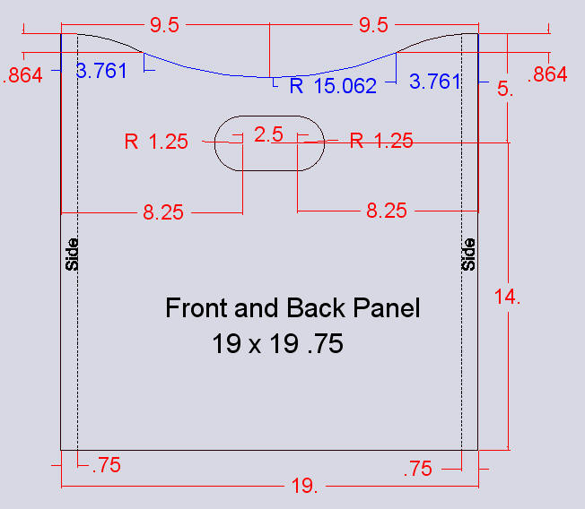

Front and Side Panel Sizes for roll around
Top frame Rail
Left and Right Side Panels 23 x 19 x .75.jpg (45.64 KiB) Viewed 17642 times
Front and Back Panel.jpg (51.19 KiB) Viewed 17637 times

Nice work George! Thanks for sharing it.
