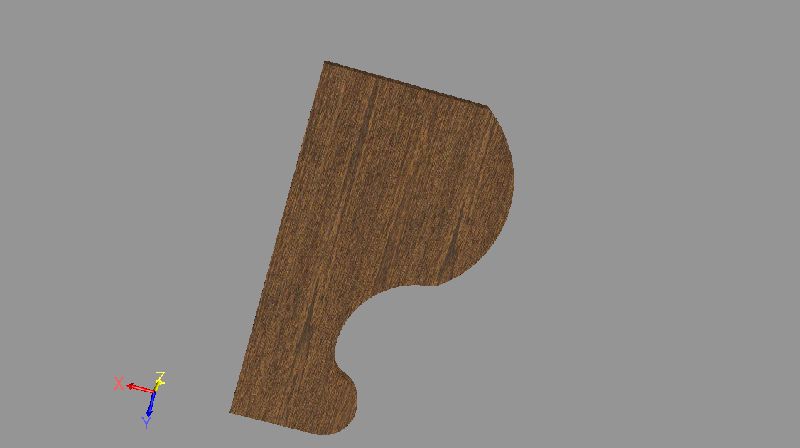

I was wondering if there is anyway to create a closed contour shape in another program (say Turbo Cad) and import that drawing into part editor for creating geometric shapes.
Had one of those afternoons where your back to "I coulda cut this thing out faster!...."
I'm trying to draw a simple ogee style profile in a display panel 5/4 thick, to be used as a simple bracket for an island countertop overhang. Been struggling with the rudimentary drawing tools in the shape and contour editor. After countless "doesn't appear to be a closed geometric shape" I've all but given up on it.
Now if I could get the drawing done in Turbo and port it into shape manager, untill this part of the program gets improved, it seems like we would really have something. Is this even possible?
Any feedback would be appreciated.
Tim

Thanks for the feedback. It has helped. I was able to load the dxf into the contour editor successfully. Bammo! Got the dxf shape, drawn in turbo, loaded right onto the panel. Went back into the part editor and tried to create the part using the loaded closed contour. AWWwwww poop! Same message "Contour selected doesn't seem to be a closed contour. Please make sure the contour is closed".

Went back and loaded the dxf ogee bracket. dropped it onto the panel, in the contour editor, and used the 'extend line' tool at every line intersection so that there was an overlap. Trimmed the lines back using the trim tool. (is it just me or is are the lines alot harder to select and work with in e-cabs than it is in Turbo?). Went back out of contour editor and selected the line for creating a shape using the closed contour. It worked! Did a lot of thinking but it finally created it. I can see this having big benefits. I find it much easier to draw shapes in Turbo or Sketchup than it is in e-cabs so it looks like two great taste in one candy bar! Keeping my fingers crossed that I can do this some more. Thanks for all the great guidance.
