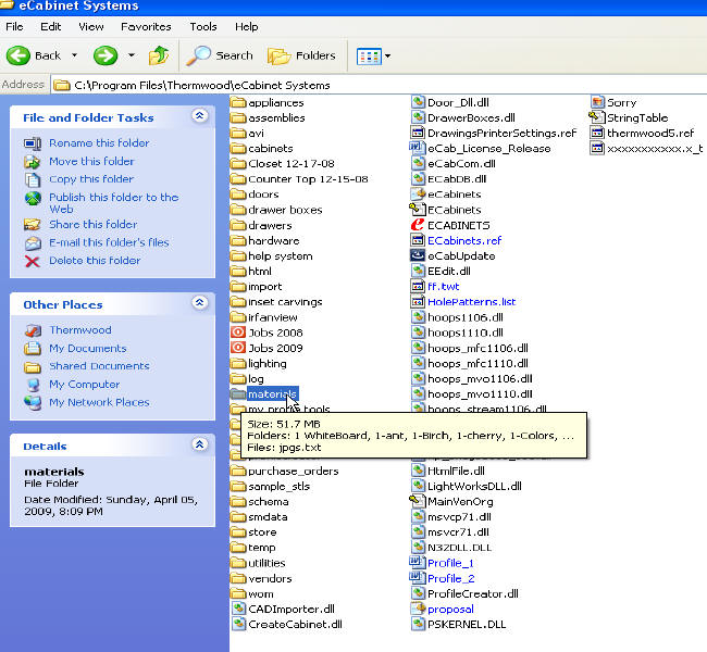

I have looked in that folder already. All that is in there are the materials that came with the software. I am looking for the materials that I added. (sheet goods)

The sheet material info is in the ecabinets.mdb file. Guess what the "mdb" stands for?
Probably the easiest way to move this information is through the eCabs backup/restore feature. To get the "mdb" file onto the second machine you will need to have the overwrite checkbox selected.

If I am not mistaken, your Material Library data is in "C:\Program Files\Thermwood\eCabinet Systems\ECabinets.mdb".

The correct and "safe" way to do this is to use the Backup/Restore ability with eCabinet Systems. Do a complete Backup on one system then use the Backup Directory from the initial pc as your directory to perform a Restore on your other pc.
