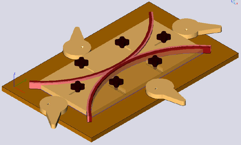

So I'm running late :?:
Door 13 x 27.jpg (46.87 KiB) Viewed 20568 times

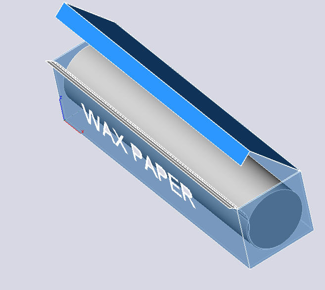

I all most for got one thing I got 2 rolls in the shop. I hate to use it up at a $1.00 a roll
Wax Paper.jpg (40.04 KiB) Viewed 20551 times
Re: Making doors in your shop
Post by Gary Puckett »
Really like the forming jig George.

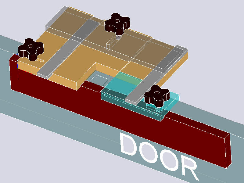

I took it from a plan :roll:
I will build it in E-Cab
Hing Jig.jpg (59.88 KiB) Viewed 20502 times
