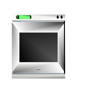

Re: Display items
Don't tease me like that...I don't know where they came from then, but here they are.
I think they are actually the same, just different names.
small oven.jpg (6.58 KiB) Viewed 6200 times
single oven small.hsf
(57.03 KiB) Downloaded 559 times
small oven.hsf
