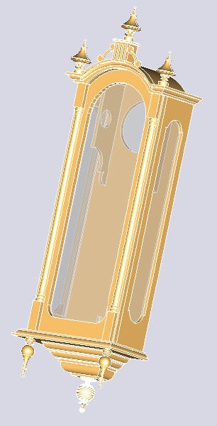

The Zip is a Hsf
It took me 9 Hr's :evil:
Clocks.zip
(1.35 MiB) Downloaded 1475 times
Vienna Clock.jpg (35.21 KiB) Viewed 25500 times
Clock_Vienna Clock_DONE.JPG (82.64 KiB) Viewed 25499 times

Re: Clock Vienna
Post by Bryan J Tanner »
:beer: WOW!!!!
That would take me 9 days :wall:
It looks fantastic!!!!

Re: Clock Vienna

Re: Clock Vienna
Bryan J Tanner wrote::beer: WOW!!!!
You're fast...it would take me at least 9 WEEKS!
Just one more great design from you George!
Re: Clock Vienna
When I get time I am going to make it in E-Cabinet in wood
Is there any way I can make the finial in E-Cabinets if I made tools. I want to learn how to make tool up :wall: :wall:

Re: Clock Vienna
George Davidson wrote:...Is there any way I can make the finial in E-Cabinets if I made tools. I want to learn how to make tool up :wall: :wall:
You certainly can George! Just take those cross section outlines and reverse them. Make a Display Cube and turn it into a cylinder then profile the edge with your tool just like we discussed in the How to Cut a Sphere thread.

Re: Clock Vienna
Here is a very rough and quick shot at it. Notice that I rotated the finished item so imagine the shape being upside-down from what is shown. This is because the operation was from the bottom of the Display Cube instead of the top.
The blue area is the material being cut away.
The tool:
The result:

What program did you use to make the original 3D? You've got some skills no lie!
Re: Clock Vienna
The 3-Fininals and the half dowels were made in ViaCad-6
Thank You Jay
Some day I wounld like to try to make the 3-Fininals in e-cabinets like Dan did.
