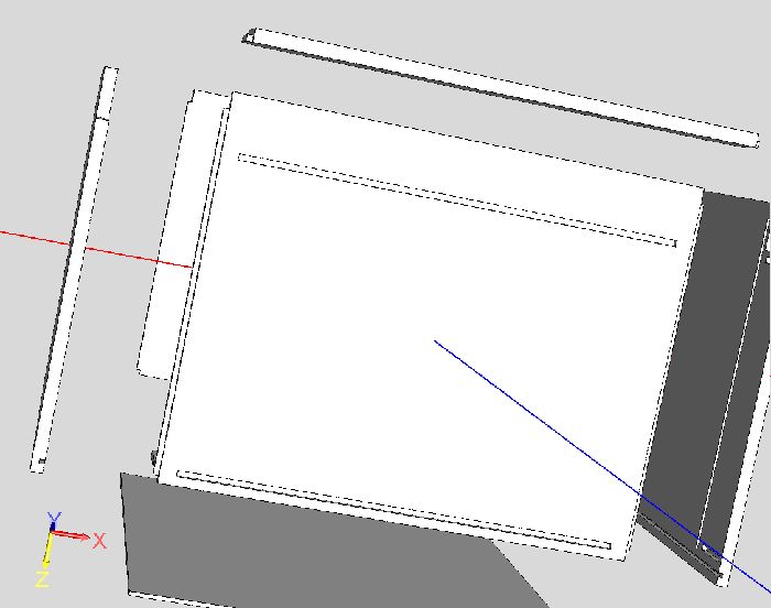

Try one more time. I can get a ¼ dado in the bottom of the deck for the toe kick but I can not get a stretcher with a ¼ inch dado located at the back of the cabinet behind the toe kick. What am I doing wrong?

Ted, here is a cabinet with a back stretcher with a blind dado into the bottom of the deck. I took the cabinet into the stretcher editor, added the stretcher, brought it back to the main cabinet editor, then brought it back to the stretcher editor, highlighted the stretcher, clicked on the add stretcher settings and the blind dado showed up. The blind dado didn't show up on the deck until I brought it back into the stretcher editor the second time.
Toe kick.jpg (43.43 KiB) Viewed 3917 times
