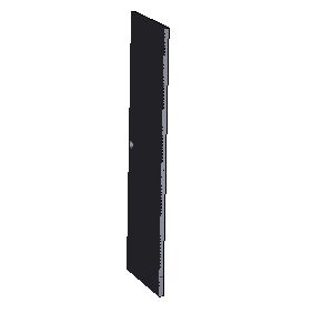

Hi all,
Hopefully someone can help me here. I am working on machining some house doors on our CNC, I have drawn them up in eCabs so I can use the part editor to machine the rebate for the butt hinges. I dont have a problem drawing the rebate but in the bottom corners of the rebates I need a 10mm radius, just wondering if someone could tell me how to achieve this? I can't draw anything in profile modeller because out machine needs an upgrade to make it compatibile so if anyone else has a tip for me it would be much appreciated. I'm also wondering if an AFL program would be better suited for this as the doors are all pre made prior to me machining them. Unfortunately I don't have any AFL or G Code experience!
Any advise or tips would be much appreciated!
Paul

Thanks for the tip but the part I need to fillet is on the edge of the door and you can only fillet on the front or back from memory??

thanks for that. I think I have actually worked out that this can't be done in eCabinets at all because the doors are all pre made and cut to size. If I put them on the router just for operation purposes using control nesting it automatically allows for an outline cut aswell. Unless I can somehow tell eCabinets that all operations are on the back of the door so it thinks its a flip operation I dont think it will work. I have tried a couple of things and short of telling the machine there is a face operation it could be a little tricky. I'm thinking I might have a write a manual program for this but I wouldn't have a clue where to start! I haven't done any manual programming in the past so it will be a big learning curve and I need to have a door ready to cut for Monday next week. Well it looks like its time for me to start learning :)
