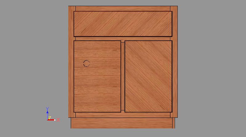

Hey folks - I'm setting up my drawer fronts with Blum adjusters, which require a 20mm hole 10mm deep. Thus far I've been using part editor to drill the holes, then constraint manager to fix them in place. Only problem, of course is if the client does something like change the angle of the grain from vertical to horizontal, I have to regenerate the drawers, which deletes the holes. Is there an easier way to make the holes - like a hole pattern linked to some hardware I can apply to the drawers? Or something?
Before you say it, I tried just clicking on the drawer in drawer/door editor and using construction settings to change the angle. It completely ignores me.
Thanks - Jason

This is an old issue and is one of those illogical quirks of eCabs. You can specify a hole pattern for hinge plates on a case side and the holes in the door, but with drawers you can only create holes in the case side for the runners. Hopefully one day they will get around to allowing the holes in the drawer front, maybe in V6!!!!

You must take your cabinet into the Door/Drawer editor then highlight the door or drawer you want to change, open construction settings in that editor and change the slab grain direction and click OK.
This will let you change the grain direction.

Kerry - you're half-right - if the grain is horizontal and I want to change it to vertical, that method will work. However, to go from vertical to horizontal grain, doesn't work. It ignores the change.
And how's this for fun - doors are opposite. I can change them to horizontal, but not from horizontal to vertical.
This sounds like a bug to me, I spose I'll send it on to the higher ups. Also, generally I think the construction settings dialogue for door/drawer editor is pretty clunky - anytime you set the angle to 90 degrees, it should stay that way, but it always resets it to zero in the editor. And it seems like there should be a separate angle selector for doors and drawers.

I don't have that problem. I can rotate grain on doors any way I want. Post your cabinet, it may be a problem with it.

Kerry - I think I just got it. And it's still irritating, but maybe this was spelled out somewhere and I just missed it. Apparently zero degrees is different for doors and drawers: for doors, zero degree setting is vertical grain. For drawers it's horizontal grain. And I was assuming that changing the angle was actually rotating the grain - meaning, if the grain for a drawer is currently vertical (90 degrees), and I change the angle to 90 degrees, that it would rotate to a total 180 degrees and become horizontal. Now I understand that the angle is actually fixed - 90 degrees is always vertical for drawer fronts and horzontal for doors.
I think it's bugging me because it's inconsistent throughout the software - when you rotate something in the other editors, or in custom layout, it's a cumulative rotation, whereas this is more of an absolute. If that makes any sense.
