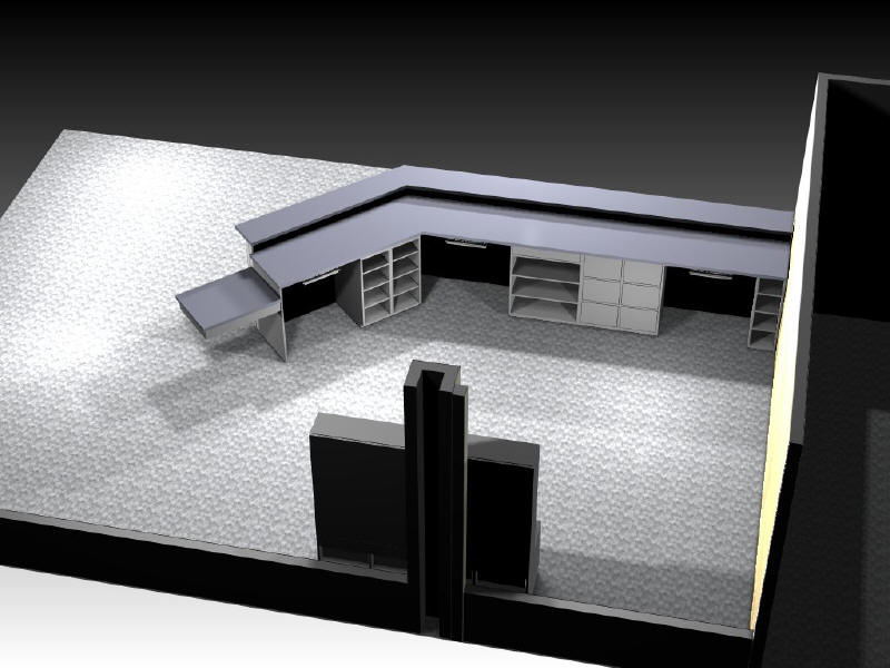

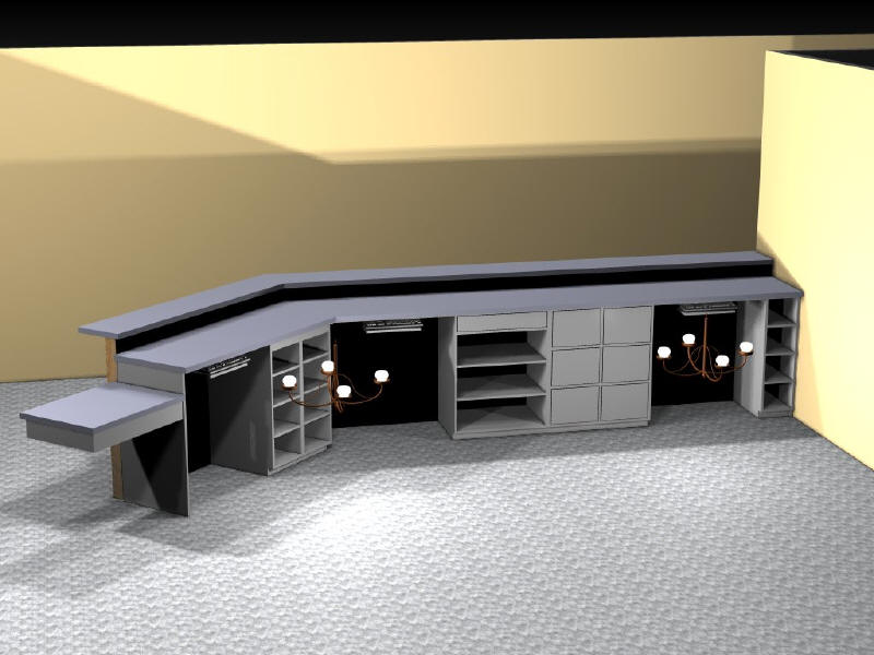

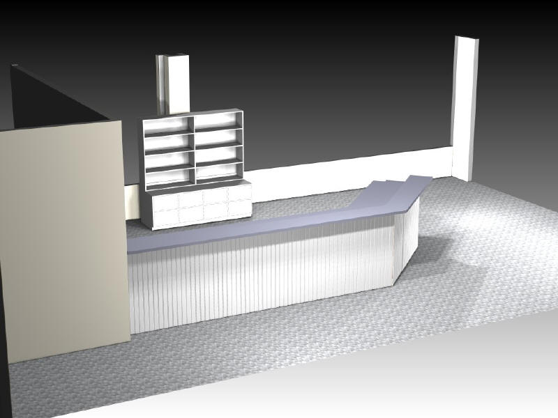

I have to make cabinets for a Doc. office all black
I would like to make them out of Mela-Ply Black. Would I use the
frameless-system 32 multitech library for them ? I have never used KD/RTA fasteners :wall:
It looks like I am going to have two more offices to do.So I would like to learn how to use them.
Any help would be appreciated.
Thank You everyone

Goerge, Yes you can use the frameless system 32 multitech library as your seed cabinet or you can also use the standard frameless cabinet as your seed cabinet. What panel thickness are you going to use? One thing to keep in mind is the multitech library was designed in metric with 5/8 panels.

Hi Chris
I would like to use 3/4" Mela-Ply Black I looked at the multitech library I did not look at the sizes at all.
