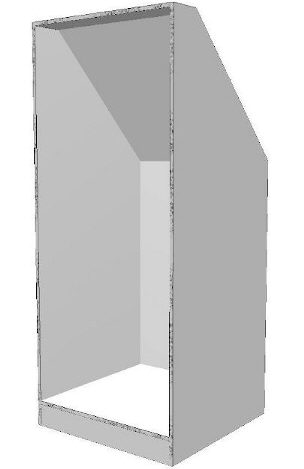

What I'm trying to design is a tall wardrobe cabinet that installs along a wall that has a sloped ceiling element that comes down and intersects with a 4' tall stub wall. I'm (hopefully) attaching a rendering generated by my CV software which shows the basic notion that I'm trying to replicate in eCabs.
In the CV environment, this modified shape is achieved by editing a side elevation view of the entire cabinet, clipping off the upper back corner (via simple shape editing), and then the sofware automatically modifies the shape of the left and right side panels, shortens the vertical back panel section and the top panel, and adds the angled back panel section. Having read through most of the eCabs manual, I'm pretty sure I need to take a much different approach to achieve this design, but I want to make sure I don't things the hard way. Here's my best guess how to proceed:

Can't seem to get the attachment to upload. Trying again....
Sample Wardrobe Cabinet

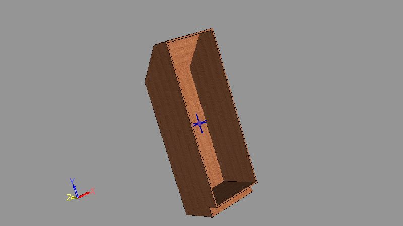

Re: How to Modify a Cabinet's Shape?
John,
I think you are on the right track.
This is basically what you will end up with using your directions.
I should have rotated the grain on the stretcher back.
