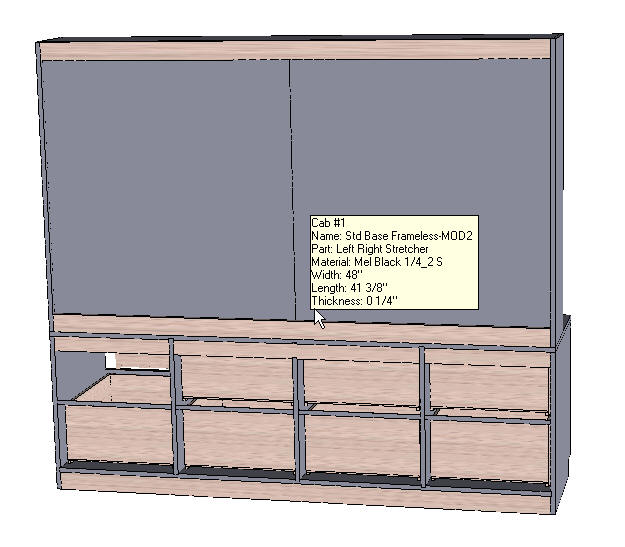

Hi Fred, yes you can, first do an inset on the back either left or right. If you want the back to be in half, then in the Inset entry box enter the size of the back, the divide symbol,and two. EG: 56/2. Then create a display panel from the same material of the size required. Using the Rotate Part and Align functions, place it on the cabinet. Hi-lite it and associate it to the cabinet. You can also give it a user name from the right click menu for ease of identification. Hope this helps.

I like to use a Stretcher then I can resizes you will have to resize the back panel
Cabinet 84 x 75.25 x 24

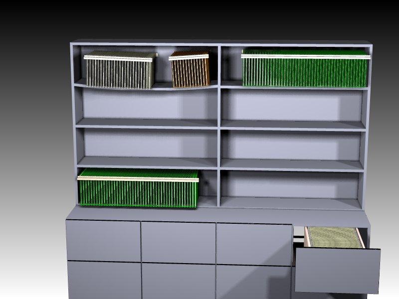

Another solution is to specify a material size of 61 x 121? Or even bigger for that matter.
If you are looking for a realistic rendering you should find a way to show those shelves sagging about an inch . That way the client will not be surprised upon delivery.

The cabinet is 72 x 75.25 x 25 the one I am building I just made the cabinet 84" to show the back panel.
I will have the check cashed by the time it starts sagging :lol: :lol: :lol:
