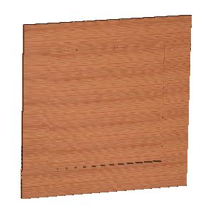

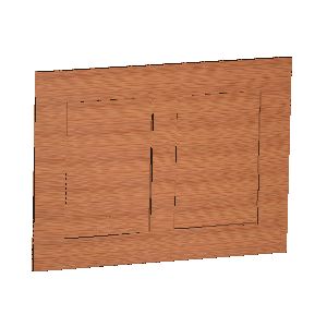

I created two panels and now I want to assemble them into a blanket chest. I opened a seed cabinet and sized it to the size I wanted the chest. Deleted the sides and front, removed the toe kick and loaded one of the front panel. Number one it loaded at the center line of the seed cabinet and I can not figured out how to move the panel to the front of the cabinet. I've attached the two panels

Hi Neal, hilite the part by clicking on it, next while holding the ctrl key, right click to move. From there you can go into the right click menu to rotate it.
