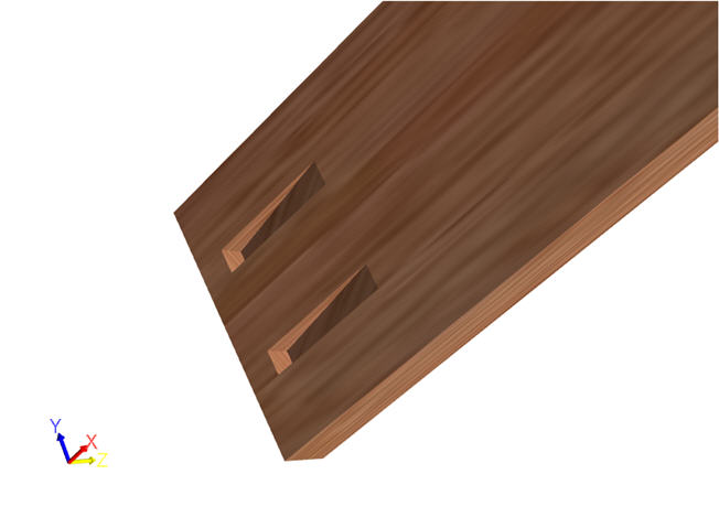

Is there a way to create a pocket with a 'ramped' bottom? I'd like to create slots for pocket screws on several of my parts. The bottom of the slot would be about 3/8" deep at one end, and ramp up to the surface of the material at the other end.
Re: 'Ramped' Pockets?
You mean like this Nat?
Pocket Screw.jpg (23.88 KiB) Viewed 6648 times

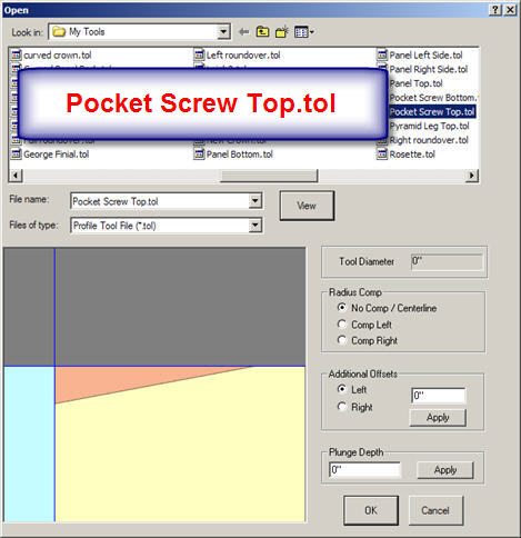

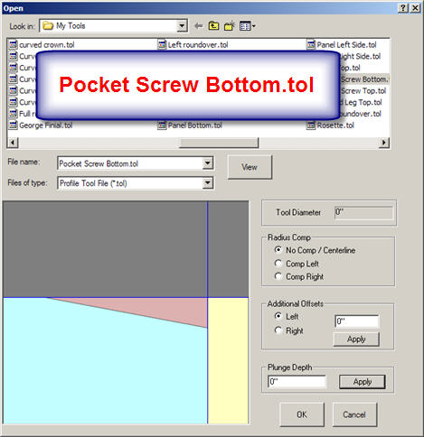

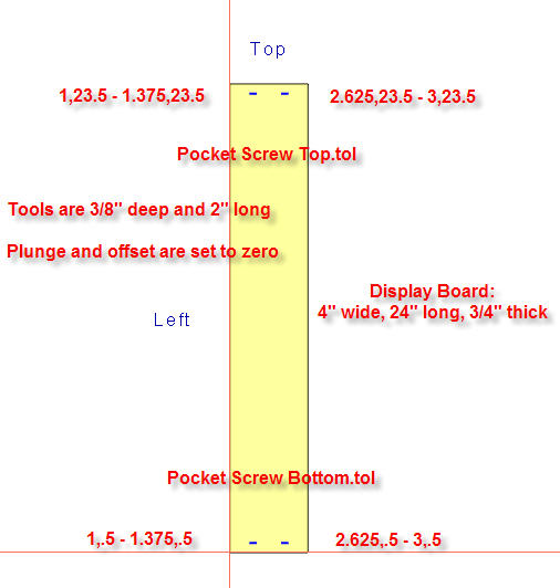

If this is what you are looking for, here is a visual explanation of how to get these results:
Pocket Screw How-to.jpg (37.51 KiB) Viewed 6639 times
pocket Screw Bottom.jpg (42.3 KiB) Viewed 6639 times
Pocket Screw Top.jpg (42.39 KiB) Viewed 6639 times
