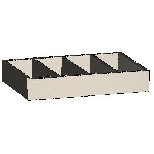

Re: Change Joint on Detached Toe
Nat,
I am attaching a detached toe that i think does what you want.
It can re size. If you need more braces just add partitions.
If you would like detailed instructions email me at kerry@kerryfullington.com

Nat Wheatley
Posts: 491
Location: Plympton, MA
Post by Nat Wheatley »
Once again, extremely helpful. Thanks Kerry.

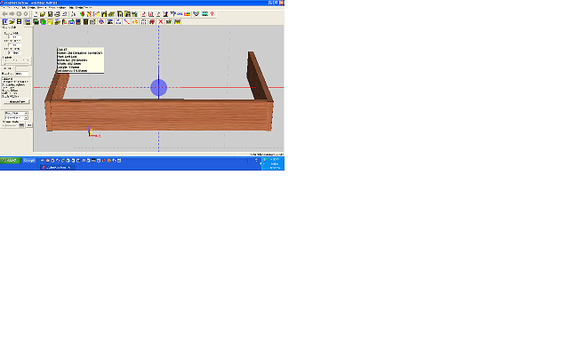

Post by Gary Puckett »
Sorry I guess I misunderstood, I thought This is what he meant.

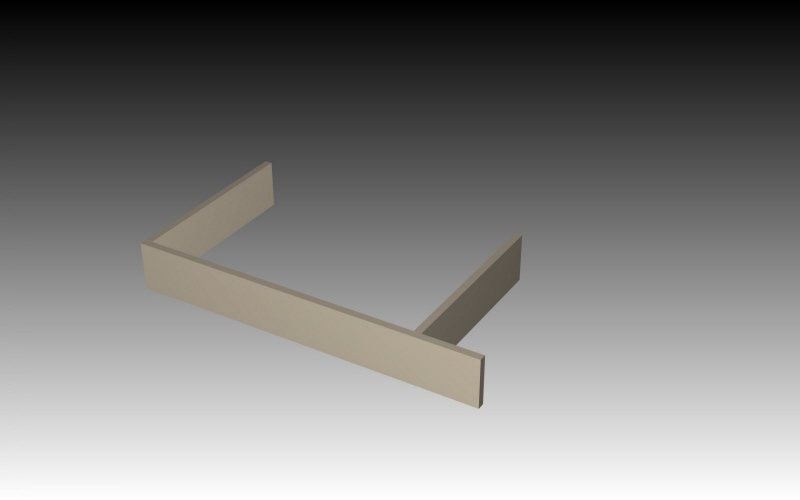

Nat,
Gary did have a better idea.
Turn on face frames and remove all the frames except either the top rail or bottom rail (it doesn't matter which one you use) and make the face frame the height of your toe and use sheet stock instead of board stock for the frames.
this eliminates the stretcher and all the insets.
Here is an example
Detached Toe 2.jpg (7.71 KiB) Viewed 6723 times
Detached Toe 2.hsf
(150.02 KiB) Downloaded 490 times
