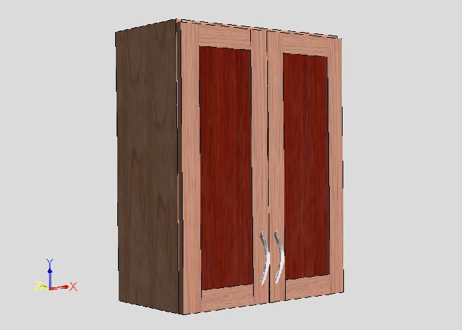

Here's what I think might be an easier approach to this problem. Place "frame only" doors on your cabinet. Add a stretcher of whatever material you want for the panel in the direction you want the grain to go. In my case I made the stretcher 20" wide and 1/4" thick. Adjust the stretcher so that it is embedded in the doors. In my case I set it to be -1/2" from the front. Set and lock the distances to the sides to be something like 1".
With 2 doors you could of course use two stretchers, but I chose not to. Using this method the stretcher will be adjusted if the cabinets are resized.
Joe
