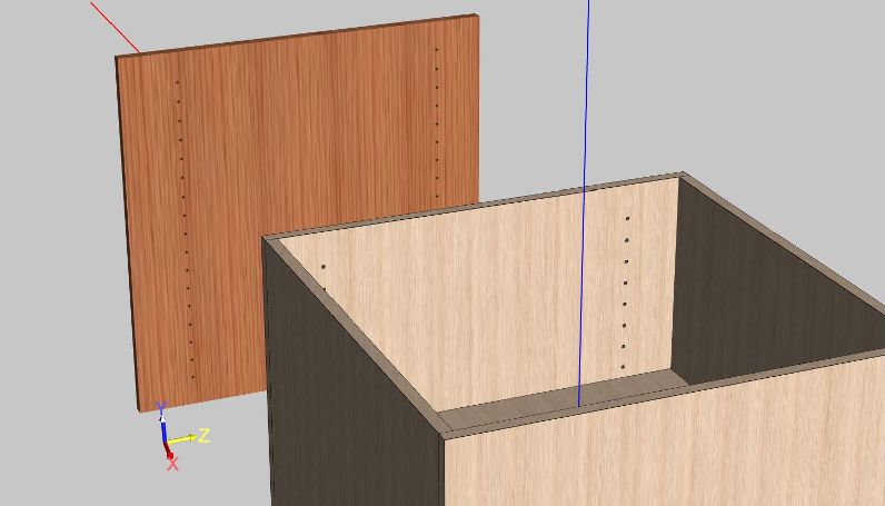

Hi Mohan,
Here's a method you can use to add shelf pin holes to parts that wouldn't normally have them. Start by developing a cabinet with adjustable shelves with the hole size and spacing the way you want. Hilite the part(side) and take it to the Part Editor. From there take it to the Contour Editor, then right click and select Create Edges from the menu. Now that geometry can be saved as a Parasolid File for use on any part. Now click on the Save Geometry icon, and select a spot to save it and give it a name. You can now bring any part into the CE, click the Load Geometry icon, select Parasolid Files, then go to where you saved the file and select it. It will then be placed on your part. Take the part back to the PE, right click and select Cut/Pocket Using Closed Contour. Then click on all the holes you want to use (they will turn green), press the Next button and input the depth required, click OK. Press Return selecting yes to the changes, and there you go. With a little practice, it becomes a simple procedure. I hope this helps you with your problem.
I did this example, which is the hole pattern from the Bin side applied to a Display Panel.
Bin with Panel.jpg (37.13 KiB) Viewed 4602 times

thanks Rick
u have given a very good detail and it has really helped me a lot .
ecabinets should have given those array and translate number of steps options in PE as it eliminates lot of double work which is unnecessary
