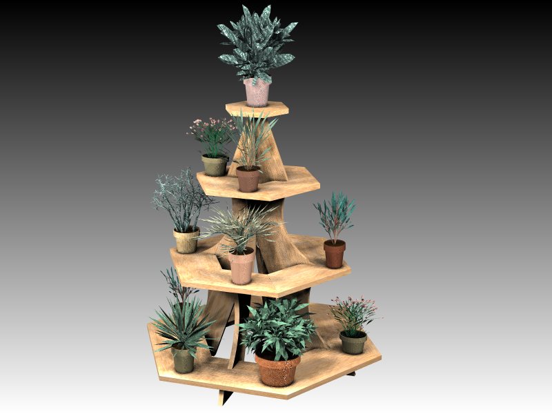

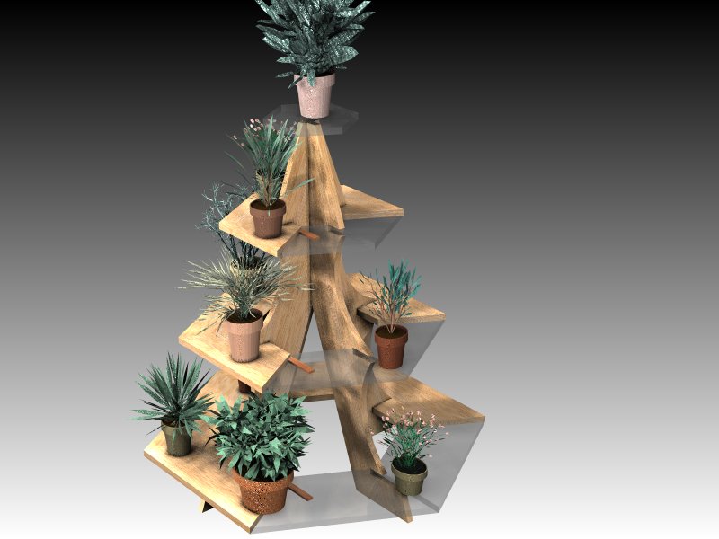

plant Shelf
plant Shelf
plant Shelf
All Plywood was made in e-Cabinet
The plants are from Kerry side yard :lol:

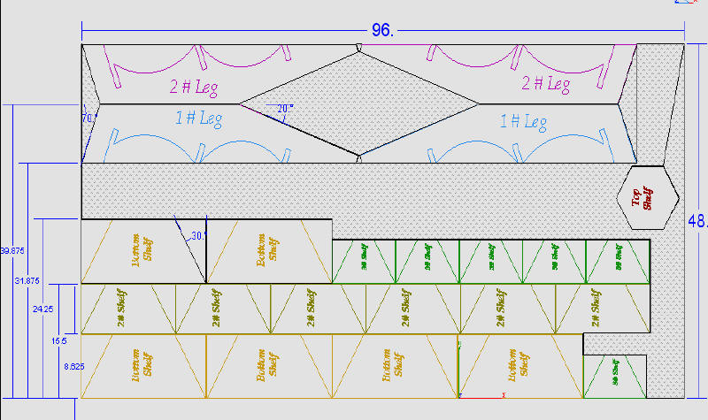

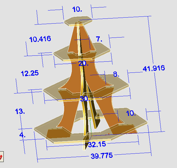

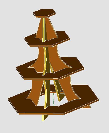

plant Shelf lay out
