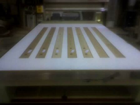

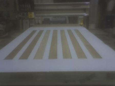

Anyways we ended up using a hybrid of davids Idea then the CNC operator made it so we could cut 7 pieeces at a time(with diferent hole patterns on each) 2.5 minutes...our little feat turned some heads...
AS I was looking at the layout on the table I couldn't help but think of machining door jambs with a dadoe for the stop, hinge mortises and a rabbet at the top for the header....maybe we could squeeze 10 per table hmmm...
Or maybe mantel piece columns....we did do a fluted arch door way today
Or maybe...you get the picture(no you didn't) but I will be assembling in the next couple of days and I will post the pic...

Post by Roger Erismann »
with and without the parts; thanks agian for your help
