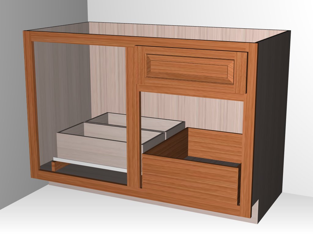

Has anyone put drawers in the back of a blank corner cabinet.
If so did your customer have any remarks about it.
Now that I look at the picture I think the sides of the drawers are to
high. They are 6 in high now?

George,
Wouldn't you lose the storage space in front of the drawer so they could slide out? So you wouldn't really gain anything.
Kerry That is right :wall:

Unless you had a pull out in front of the back drawers and raised the back drawers up a little to clear the slides of the front drawer.

That's actuly good idea. I did a job that was resolved in similar matter.
However it was not done on eCabinets, or cnc.
That will work
Thank You Lamar

I have been pondering a solution for this situation for a long time and was not able to come up with simple answer. All of the pre-fabed insets for corner cabinets are outragesly priced, although I see why. I have dreamed up some pretty elaborate contraptions that, in reality, would probably not hold up over time. It wasn't until I saw your drawing that the light went on. Thanks
