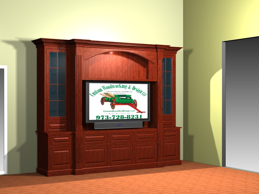

I downloaded the 5.1 build 2 version and I was able to open the files after that with no problem. Thanks for everyones help on this I'm sure I'll have more questions later :-) right now i'm trying to load my logo image onto a plasma tv in parts editor. The image is loading on a 45 degree angle. I try to rotate it but it rotates front to back not side to side. Any ideas?

John Franzino wrote:right now i'm trying to load my logo image onto a plasma tv in parts editor. The image is loading on a 45 degree angle. I try to rotate it but it rotates front to back not side to side. Any ideas?
Thanks for the help
John
John,
In the cabinet editor, load up a display cube and attach the image. Make sure the image application is set to stretched. This is just another way to get the same effect.

Post by John Franzino »
Ahh!! Thank god for you guys and this forum, this computer would be a wheel chock for my truck by now :-/ Thanks for the help
