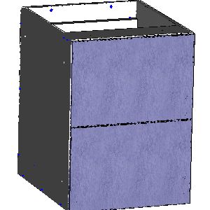

Liam Preston
Posts: 5
Joined: Thu, Feb 22 2007, 2:14AM
Location: Ballina, Northern NSW, Australia
Post by Liam Preston »
Here is the Jpeg if you need it to.

Post by Thom Davies »
Liam
The new build 2 fixes this KD fitting problem.

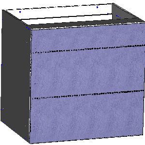

The cabinet i uploaded to you was played around with after build two was installed. I will give you another one to you to have a look at.
470 W 640H 555D 2 Drawer New.hsf
(790.75 KiB) Downloaded 463 times
470 W 640H 555D 2 Drawer New.jpg (15.5 KiB) Viewed 7314 times
Todd Miller
Post by Todd Miller »
Liam,
I added the back top stretcher back in at the same width as the front stretcher (4.7244\") and hit ok. This should update the cabinet with the back stretcher in place. Then, I went back in and changed the back stretcher value back to 0.0\", then hit ok. This seemed to fix the problem.
So, basically what I did was added the back stretcher, let it update, then went back and took the back stretcher out again.
Todd Miller
Liam,
Sorry about the confusion. I now know what you are talking about. You are talking about the hole on the underside of the deck. Disregaurd the previous pm.
You should just be able to take the deck into the part editor and remove the holes. The reason this has happened is because of a bug in version 5 build 1.
With build 2 installed , load up the cabinet and remove the holes in the deck through the part editor. Let the cabinet update and you should be fine.
