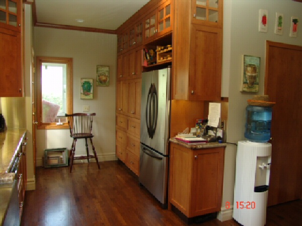

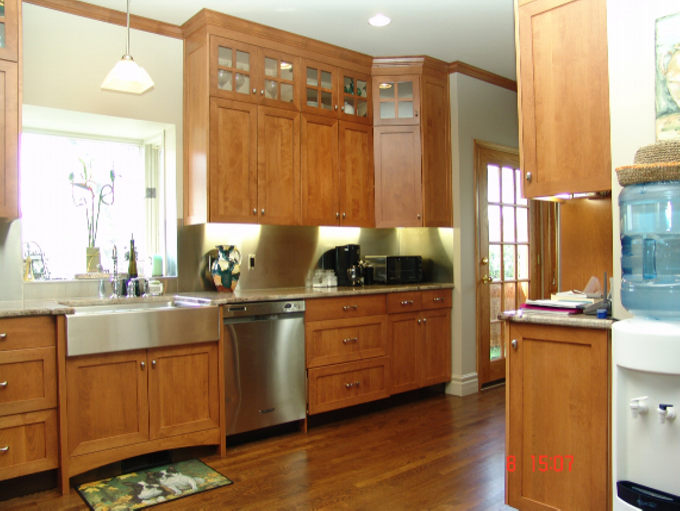

Here are a couple of pictures of a kitchen I did about a year ago.
Completely frameless.
DSC00275 (2).JPG (104.12 KiB) Viewed 17181 times
DSC00256 (2).JPG (770.51 KiB) Viewed 17183 times

Jean G Voyer,
Those are very nice. What about the sink cabinet? It looks as if it has some sort of frame or \"second layer\" to give it the extended look that it has.

Those are two applied panels with a false decorative leg at the front. A skirt at the bottom join the two panels.
The cabinet is just below the sink and between those panels. That cabinet is completely without frame.
The whole thing is inspired by mission and shaker styles.
I found over the years that you can do just about anything with frameless.
I even build furniture with frameless unit and then you just add decorative panels and other parts that are related to a particular style.
Some time those pieces of furniture are pretty heavy.
