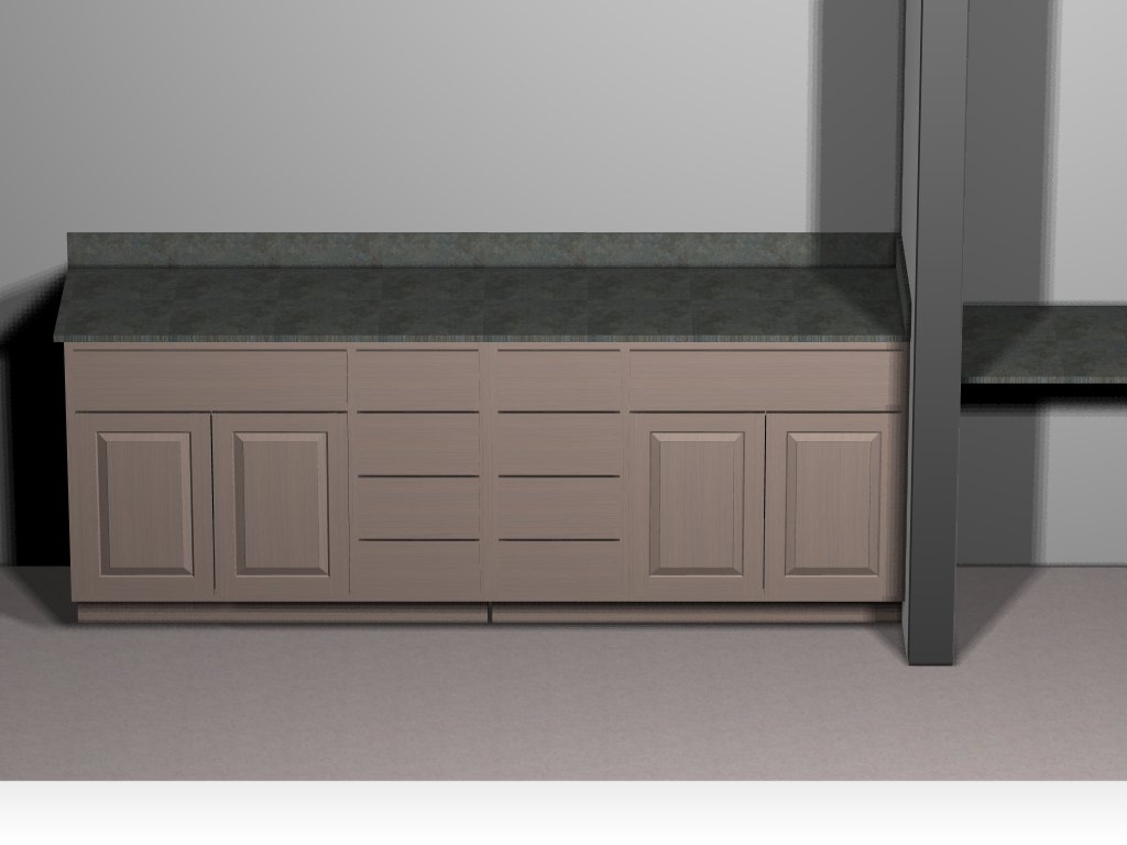

I have a similar problem. I have attached a job that I started in Build 2. I need to delete the 45\" countertop on the right. When I delete it and try to save the file, eCabinets hangs. I needed to make several changes to this job and then couldn't save it, so I started making changes one at a time to find the problem. Thats why there are no cabinets below the countertop.
Countertop problem.jpg (60.7 KiB) Viewed 6929 times
Lee
