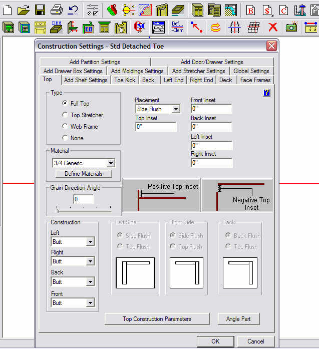

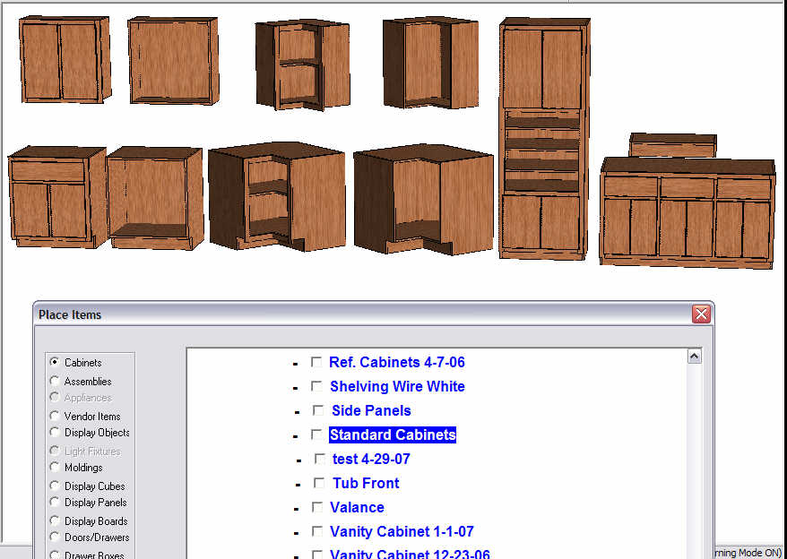

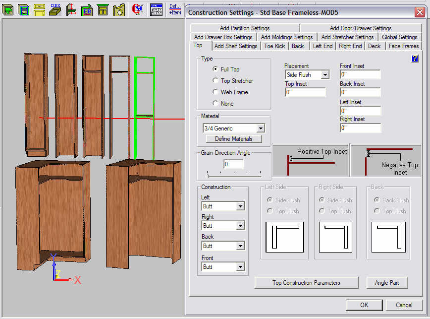

Hi Tom
Kerry has a very nice Closet Library that would get you ahead.
Here are the standard cabinet in the program
A-(Standard Cabinets) that are in the program that you Start with.
B-Your (Construction Settings) in the program
C-Some of the things you can do with the (Construction Settings)
My personal opinion is \"if you picture it in your mind you can build it in E-Cabinets\".
