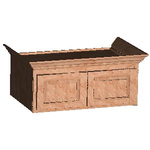

I changed the size of the mid stile on this cabinet by highlighting the stile and going to page 2 of Face Frame Construction Settings. When I return to Main, the door sizes haven't changed. Do I need to remove and add the doors to update or is there another way to get the doors resized?

2nd Issue with same cab
I took the cabinet into Cab Editor from the Batch List;
Changed the mid stile width
Selected Door Editor and deleted doors
Now when I select the left opening, the mid stile is not recognized
and the both openings are selected as one
If I take the same cabinet into Cab Editor from Detail Room or if I use the Load Item and bring the cabinet in from the file, it works fine.

This is something that has a similar reaction with frameless cabinets...
If a fixed shelf openning is changed in height the doors/drawer will need to be removed and reset.
One would think that if a rail size is changed it would resize the doors. As well as fixed shelves...
