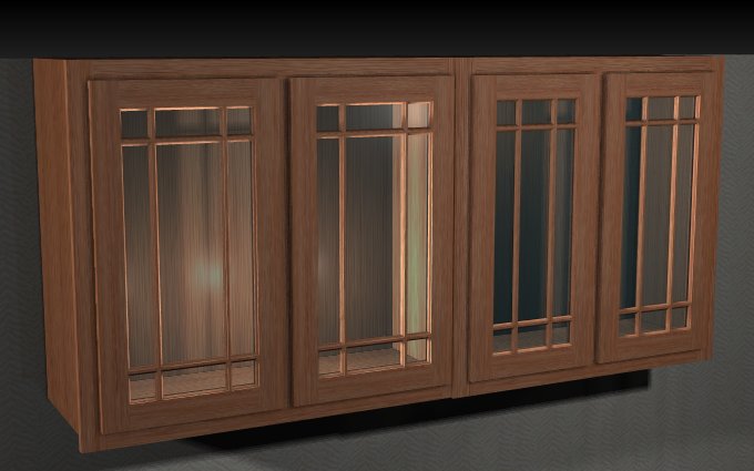

Adjusting the height works especially well for light fixtures, to highlight different things in your room renderings. Since they will go right through installed equipment such as cabinets, you can move the smaller light fixtures into a cabinet opening, hide the lights, and it will look as if the inside of the cabinet has lights!
In the attachment, a quick test I ran, the main difference between the left vs. the right cabinet is the number of lights inside each one: I placed 3 lights in the one on the left, and only one in the one on the right. And the differences show.
Lights in cab with glass door.jpg (40.68 KiB) Viewed 7681 times
Al
