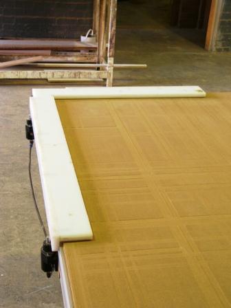

Hi Brian. I cut a flip-op fence out of nylon or polyprop or Tufnol or somesuch. I had the CS 40 cut it in location clipped onto the corner of the table with downstands so it is accurate. Simple and cheap or cheap and nasty depending on your point of view.

OK guys I finally got into gear and snapped some pics. The fence I have made you will notice has pieces that go down vertically (downstands) allowing one to locate it onto the edge of the table. Notice also the little pop up pins I have bolted onto the edge of the table. These are relatively cheap pneumatic pistons which I am also using to locate parts but am still refining the workings.

Thanks for the pictures Nick. I understand what you are doing now.
