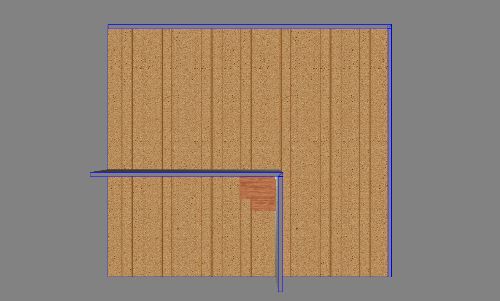

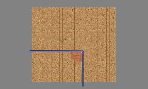

I am not sure what you mean by "wall remnant". In the next two images I have hidden the 1-inch wall that is farthest from the origin, and all seems ok.
Al

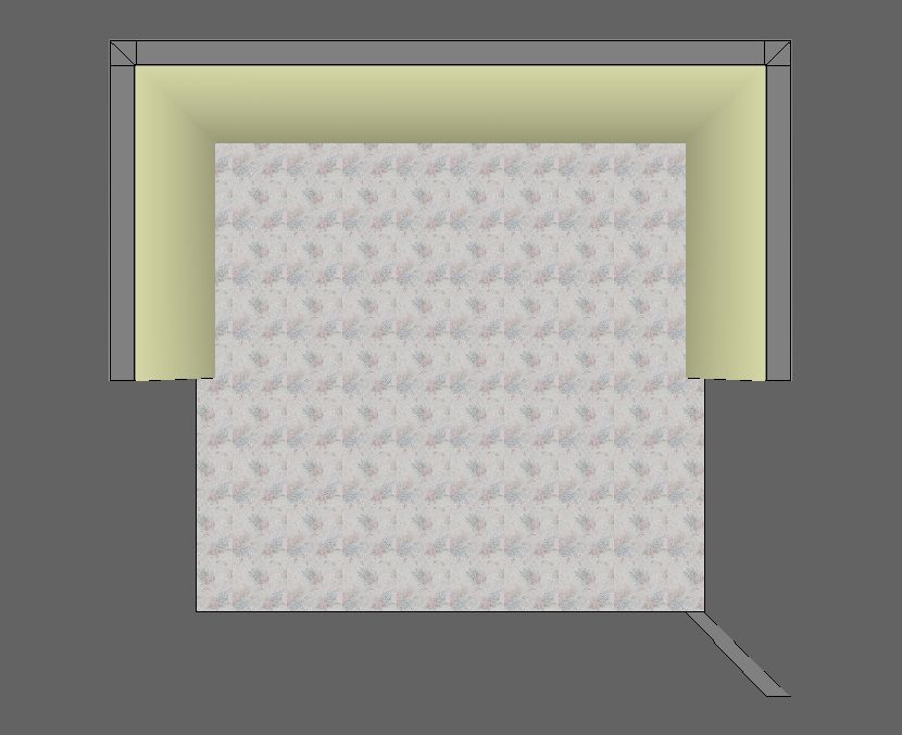

Could you not run your walls wild and then make a full height cutout in the wall?
