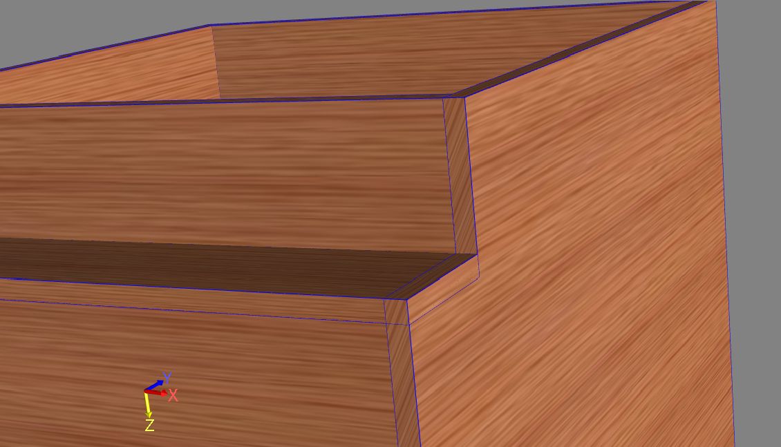

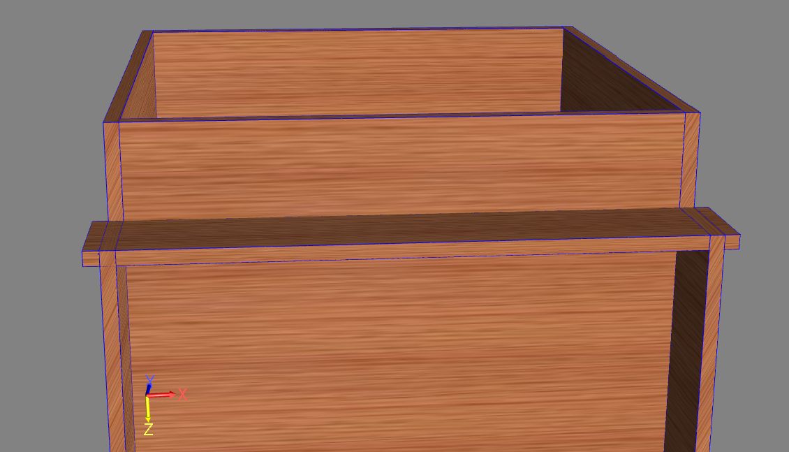

I was over-doing it...  Using the full dado joint setting.
Toe kick-miter for cut list.jpg (74.49 KiB) Viewed 4833 times
But I think THIS is what you mean - is this one correct?
Toe kick-miter for cut list-2.jpg (80.66 KiB) Viewed 4833 times

Al,
We had to use the \"full dado\" trick in earlier versions of the software because there wasn't the \"Inset\" feature. The full dado was the only way to lengthen the kick. That is no longer the case.
Michael Yeargain
Location: South East
Post by Michael Yeargain »
The first picture is the correct way Al...

NOW I know the REST of the story. Thanks again, Kerry!
And thank-you also, Mike. I have learned my new thing for the day... :lol:

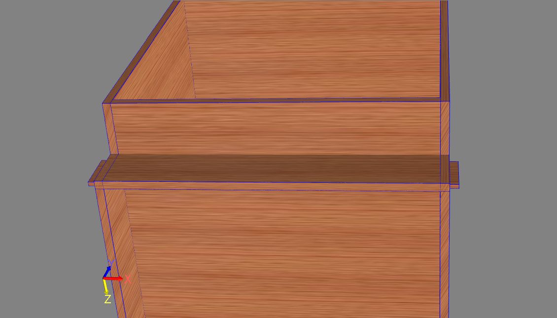

Just for kicks, I also tried setting the joint to Blind Dado AND the offsets. This yields a funky joint, into which one could insert a lock key... I don't think any client would want THAT in THEIR kitchens. :( Don't know whether to laugh or cry... But it must be part of the learning curve, I imagine.
A truly funky joint - ready for a lock key :-(
Toe kick with blind dado and offsets-3.jpg (71.16 KiB) Viewed 4820 times
