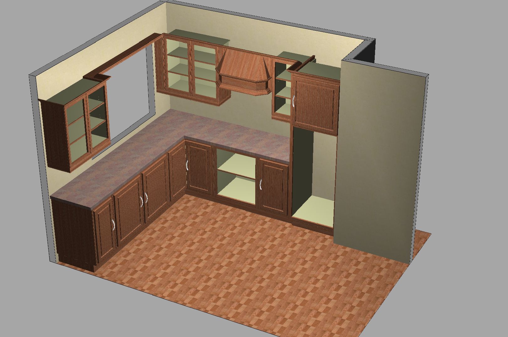

This is it I think. It was not where you said. Does it matter where the file is? Would that slow it down?.
Hughes Tom Kitchen sample 1b.jpg (196.89 KiB) Viewed 15051 times

If it was saved somewhere under MY ESJs then its ok, but what you attached is a jpg I need the esj file. :D
