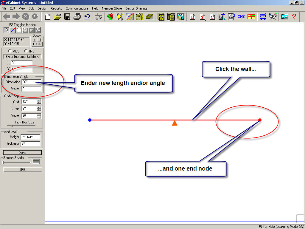

Can anyone tell me if I can edit the wall length of an existing room? I created a kitchen based on customer supplied measurments. Now I'm doing the job and when I went to measure there were some discrepencies and I hate to start over. I have some time in the walls, cutouts etc. that I would have to recreate.

Sure...in the Wall Editor as shown in the attached image.
wall edit.jpg (111.67 KiB) Viewed 5945 times

Thanks Dan,
I was pretty sure it could be done, in fact I think I have done it before. I just couldn't remember and was not able to find a reference in help or the forum, I was only clicking the wall and not the end node. I did however notice that when I click on a wall and the subsiquient end node it highlights the wall built previous or former to the highlighted one depending on which end I choose, I suppose I'm doing something dumb again. I was able to work around by modifing my selection points. Sorry for being so thick and thanks much for your prompt and helpful reply.

No problem. If you have an adjoining wall you need to select the intersecting node and both walls. The enter the ADDITIONAL length in the Move Increment boxes--X = horizontal wall and Y = vertical. Use a negative number to shorten the wall.
