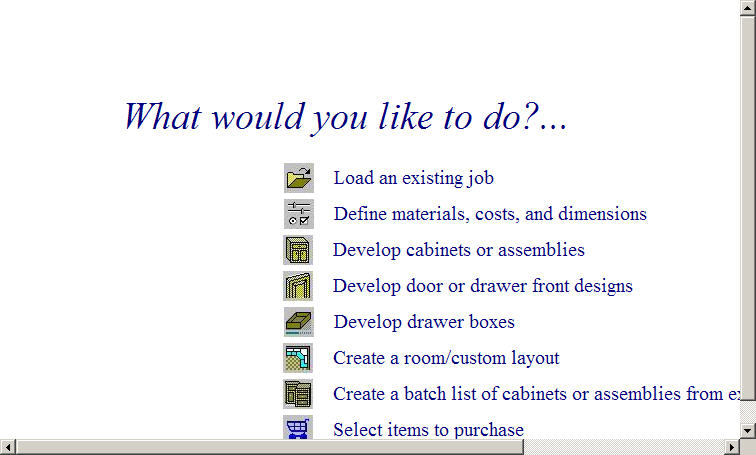

I think the Client area is where you have your window that you want to capture not covering the whole screen. It will just capture your window and not the desktop behind the window but you will still have all the menu and tool bars showing. You would have to crop the image to get just the line drawing.

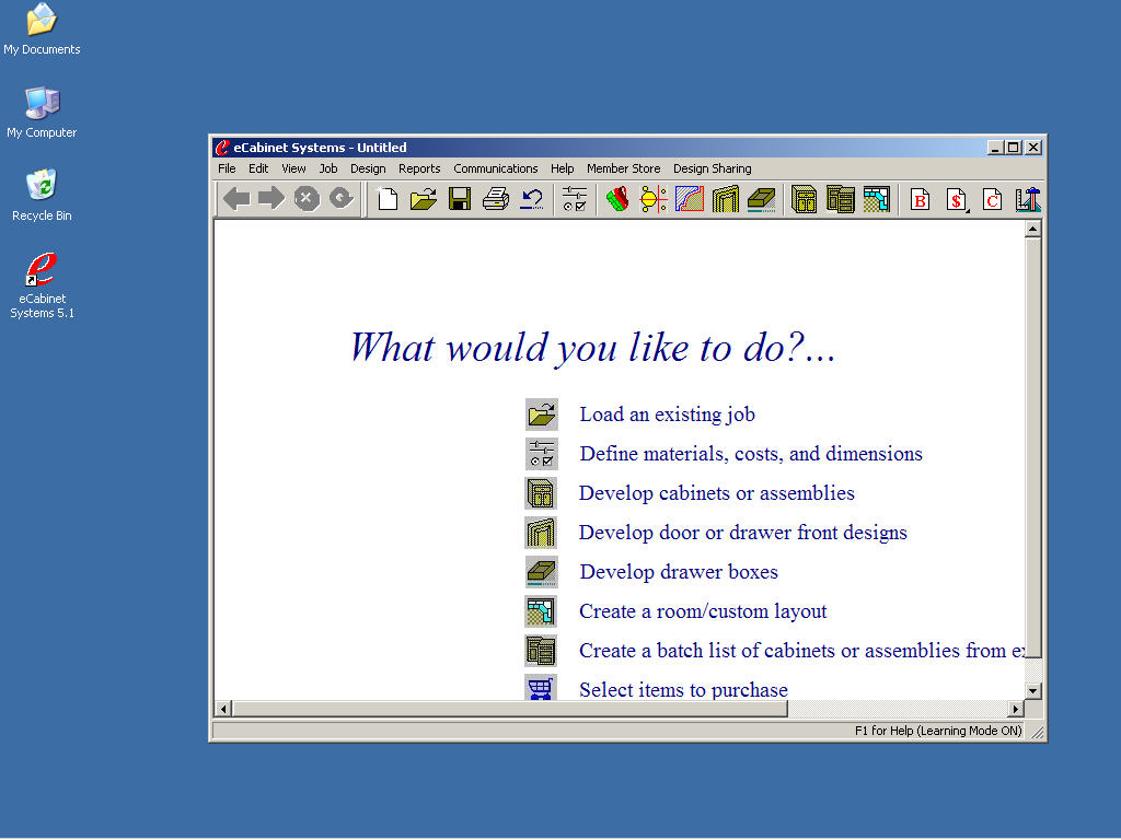

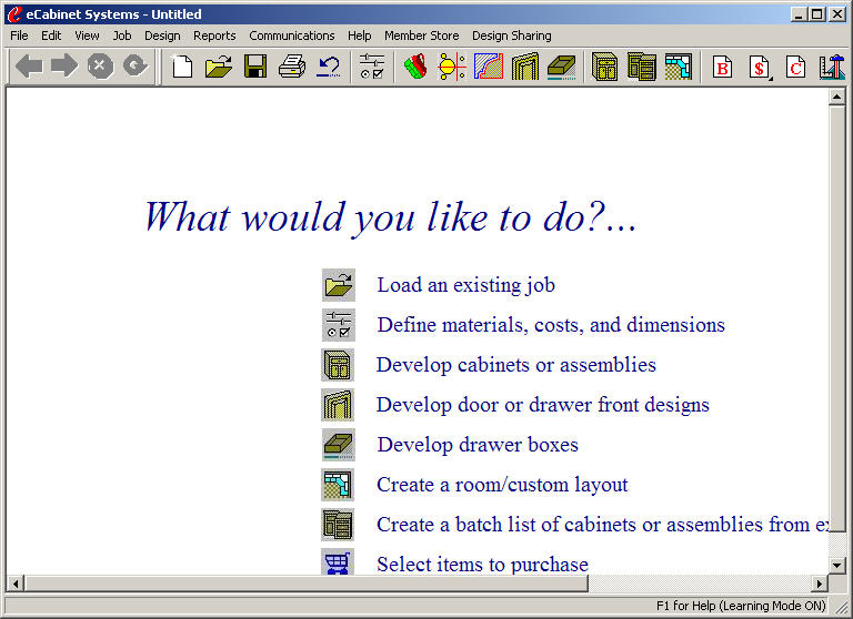

That is correct...full screen is just that, everything that you see on your monitor. Foreground window is only the active window and client area is the active window minus the border and title bar.
Screen shot - client area.jpg (57.39 KiB) Viewed 4994 times
Screen shot - window.jpg (86.16 KiB) Viewed 4994 times
Screen shot - full.jpg (106.78 KiB) Viewed 4994 times
Bear in mind that I used a different screen capture program (Snag It) and the client area capture does not have the icon bar but with Irfanview it will be there.
