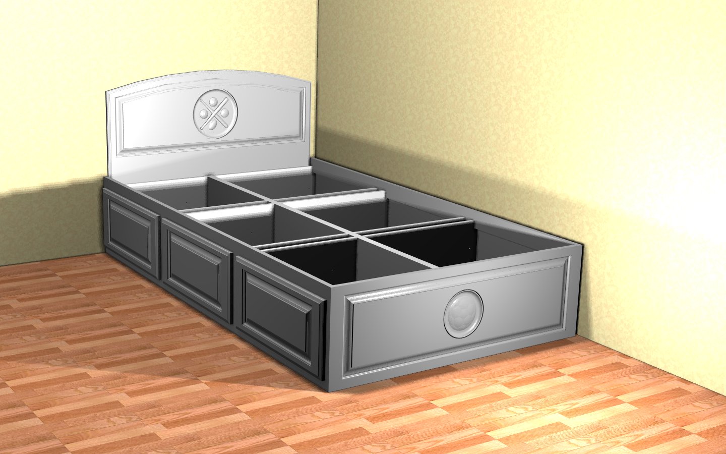

It worked good. I just don't know what level of job I would ever use it on. I made this bed for my grandson. It has 3 drawers on each side and I used the sports ball knobs.The whole bed(MDF) was cut on the router(just to prove I could). Faceframes, Drawer Fronts, cab parts, Headboard and footboard with carvings, Metabox drawer bottoms and backs.
James Bed.jpg (175.81 KiB) Viewed 9596 times
