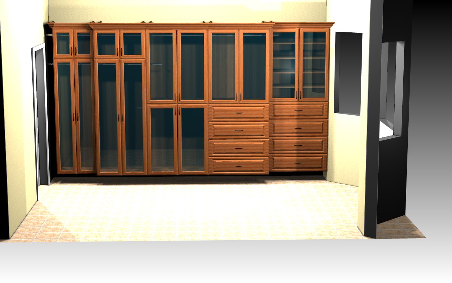

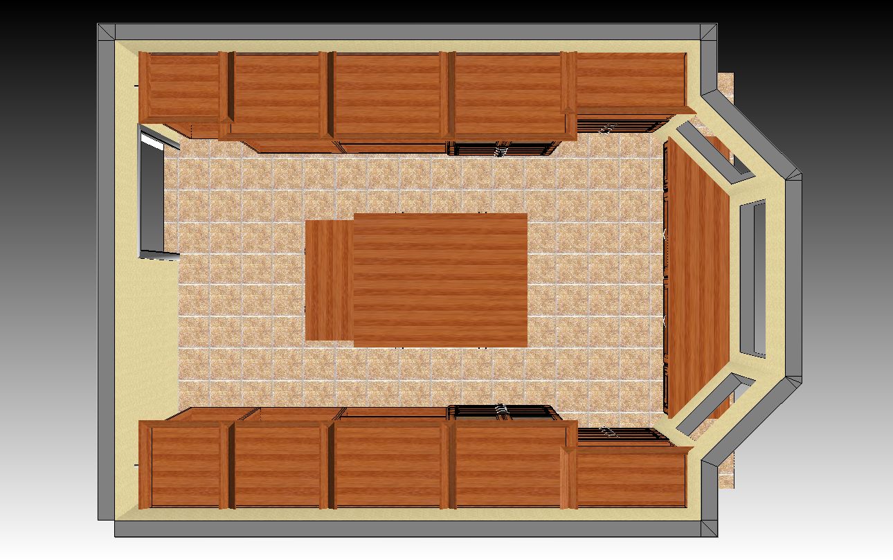

I'm working on a $12K Summer Flame Melamine closet now. I just got the mt'l, banding, rtf doors and df's. I haven't cut yet. I plan to use all blind dado and assemble with screws using pre-drilled holes. Loose toe kicks, sex bolts, RTF Crown. Any suggestions? The best part, it's 50 yards away from my house...

I notice the window seat you have not cut the back of the cabinets, This is a pain in the @$$ as I'm sure you know.
Frameless cabinets here will give you trouble if you don't use a solid filler about 1 1/2\" wide Min 3/4\" wide. This will help the transition to the angular cabinetry that has no substantial left or right side.
The crown by the entry door at the top may pose a threat as well. Check with the builder on the size trim they will use, or if this is an older house, make sure the door trim and crown don't collide. Although you look okay.

I ordered an RTF Drawer front to rip and use as filler scribes for the window seat. The walls are actually 8'(not 9' as shown) and I will continue the crown around the room.

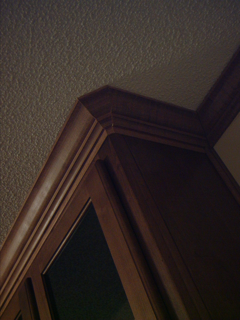

With the frame-less cabinets you don't have the luxury of a top rail to nail to, so you will need to use crown with a freeze plate or install your own before you run the crown.
I make my cabinets 2 7/8\" (my crown bed) lower than the ceiling then I add the freeze plate and crown. The crown will bed out just above the upper doors and this spacing is critical!
Another thing I do on some things is a double cut mitre.

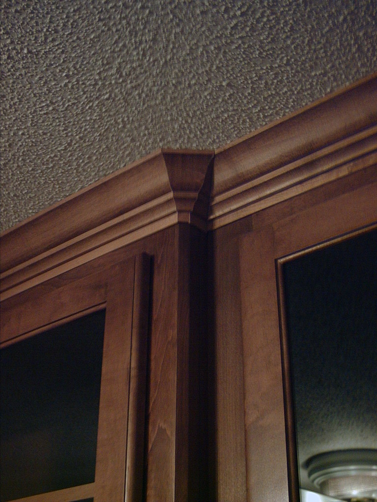

Michael Yeargain
Location: South East
Post by Michael Yeargain »
This type needs a practice run before you actually make a cabinet. The depth of bed of your crown must reflect the depth of the protruding cabinet to work!
Many moons ago I had to build another center cabinet 1\" deeper, because the crown would not work... :cry:
The homeowner would not let me pull the cabinet out 1\" :cry:
