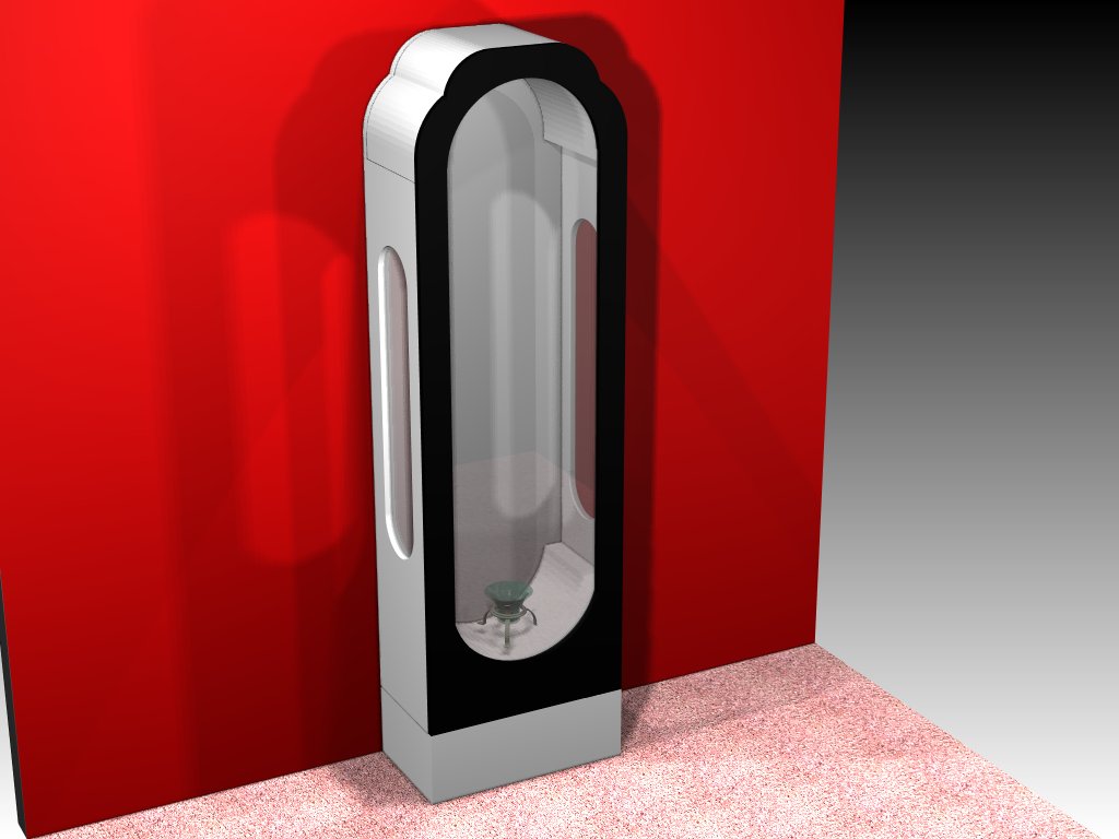

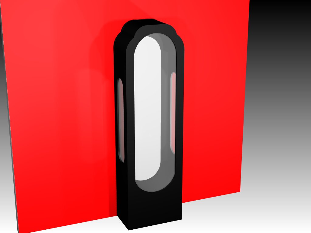

The clock was black I wanted to change it all to white.
It will not change the rails and Stile to white.
I get (There was a problem in boolean Outline and Route bodies) :?:

NO luck Todd
I have tryed Oak,Cherry,Maple No luck.
It will start to work Oak will come up then I get
It will go back to Black :?:

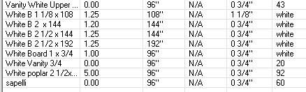

Thank You Todd
I put your file in with new mat. in and it worked fine. I did have the box unchecked. Here is the whites that I had in my file but yours worked
