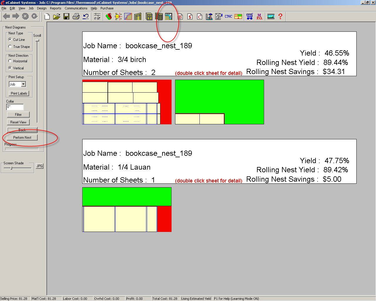

To create a nest diagram you must either create a custom layout (room) or use batch cabinets.
For your purposes it would probably be easiest to use batch. Just click on the \"Batch Cabinets\" icon then add whatever assemblies you want nested.
Once you have added everything to your batch, click the \"Perform Nest\" button.
I just noticed that the picture I posted has the wrong icon circled for batch--it is actually the icon to the left of that which is circled.
Sorry for any confusion. :oops:

thanks it works!!
