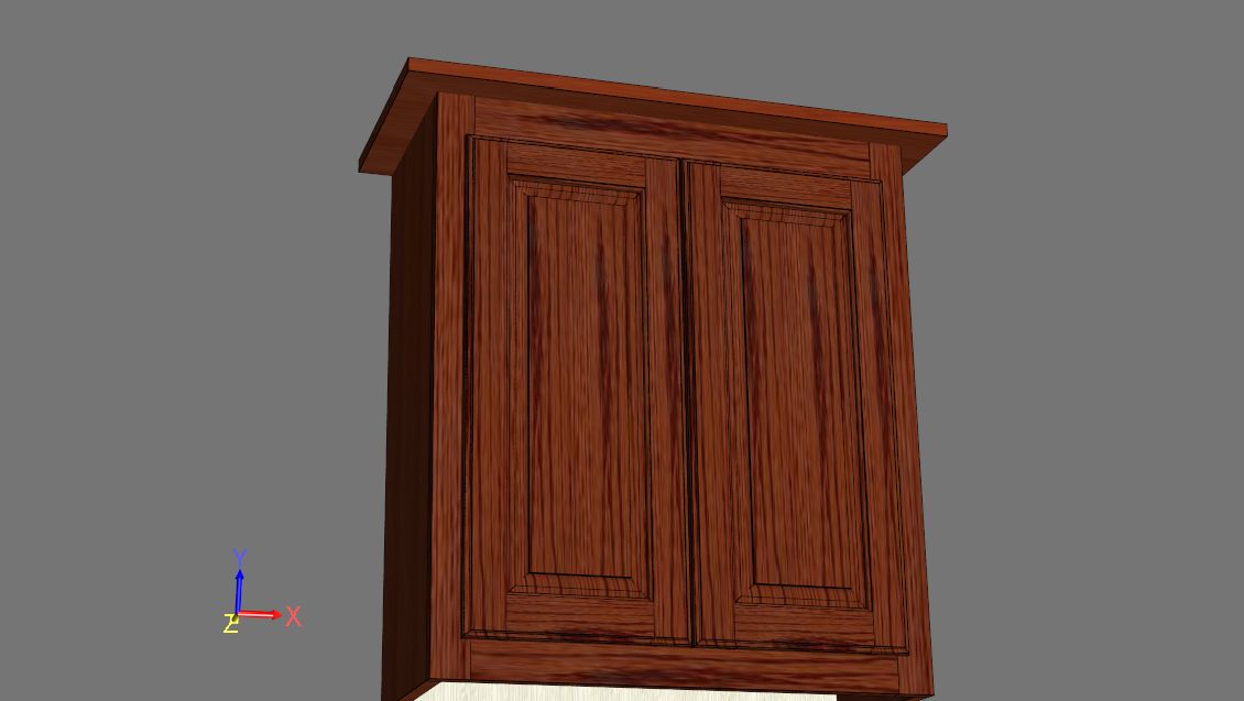

I hope this is not a totally stupid question but I am just beginning to try to learn this program. Totally intimidating. I am triing to put a top on a cabinet with a 2\" overhang on both sides and the front. I will put my crown under that. Looking through the manual is like looking for a needle in the haystack. Any help is greatly appreciated. Thanks, dave

Open your cabinet in the cabinet editor
Click on Construction Settings
Under the Top Tab Select Top Flush using the Placement Drop Down Menu
Under Front inset enter a value of -2 3/4\" (if this is a frame less cabinet enter -2\")
Enter a value of -2\" under Left and right insets
If this is a face frame cabinet click on the face frame tab and enter a value of -3/4\" in the Top Rail/Outside Scribe box
click OK and you will have your cabinet
