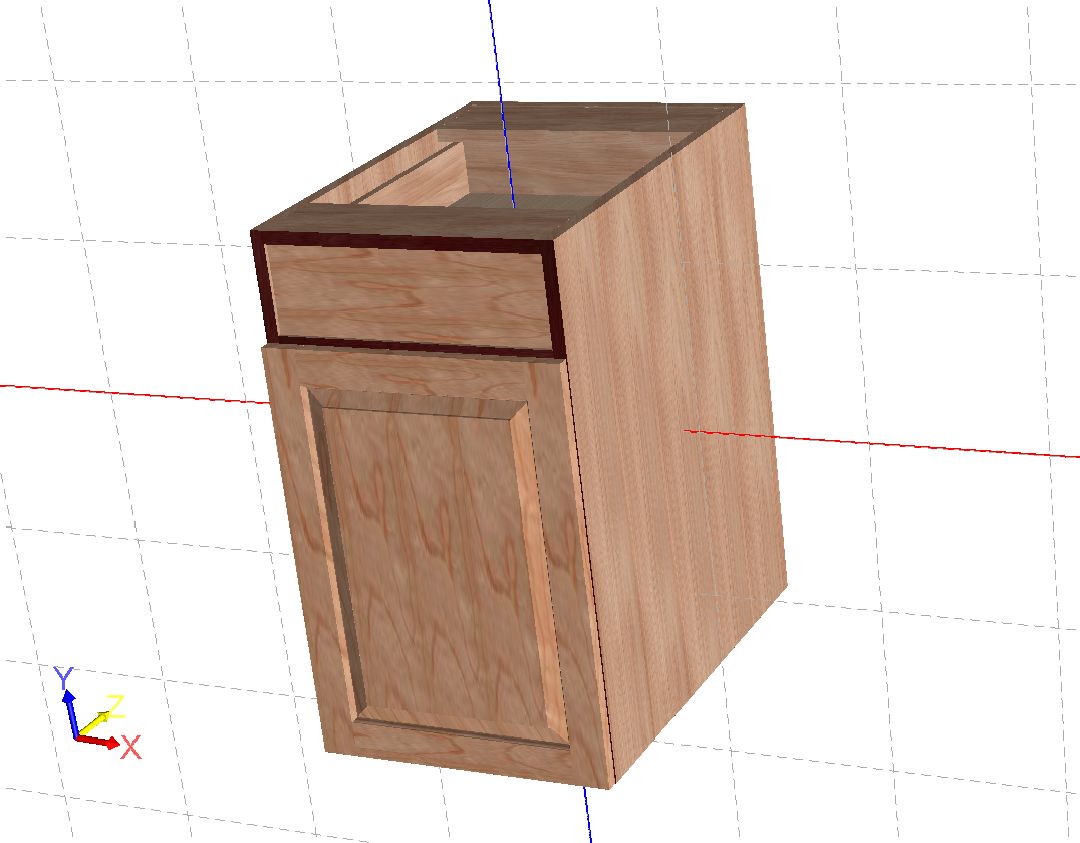

It seems as if I was reporting a fault (read: bug) in that cabs behave badly when outfitted with drawers, and a resize in the Z direction (cab depth) is attempted.
Without any hysterics, a member of the Thermwood team has reported earlier in this thread that it is fixed in 5.2.
Thanks, Thermwood!
Shown here is what happens to one of my seed cabs, a simple frameless base with a door under a drawer. The cab came in at 23.75\" depth, and what you see is what happens when I changed depth to 25.75\".
When I said \"pooch out the back\" in an earlier post, what I meant was that a depth increase should make the cabinet back retreat in the +Z direction, with widths of deck, sides, etc. all increasing accordingly, while the drawer remains fixed. Apparently, the software determines that the distance between back and rear of drawerbox should be fixed, holds it there when the move is made, and drags the whole drawer into the cabinet.
I did not say that the drawerbox pokes through the back. Sorry for the misuse of words.
The workaround is to resize the cab, depth-wise, then delete the drawer, and add the drawer back. Everything is fine then.
