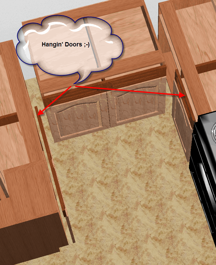

You may need to \"reapply\" the doors or at least take them to the PE after replacing them as they sometimes tend to \"hang\" in front of the cabinets. I'm sure there is a thread about this somewhere. . .
