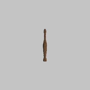

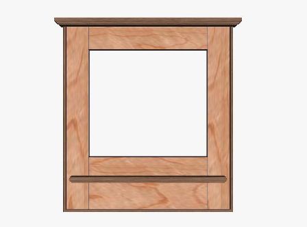

So as you can tell, I do a lot of weird stuff besides cabinets. The hall mirror I built for my kids for Christmas has mini shaker pegs to hang keys on, does anyone know if you can create those in this program or import them form something else? The mirrors are already done, but I would like to have them in my 3D drawing and not just in my 2D Design Cad drawings. Here is what I have so far.
Hall Mirror.jpg (12.57 KiB) Viewed 10243 times

Sure. You can create them in the Part Editor. There might even be some posted in the Customer 3D Files forum.
Re: Shaker Pegs
Tony,
This isn't a "Shaker" peg but maybe it will work.
You can scale it to any size you want also.
peg.hsf
(50.02 KiB) Downloaded 796 times

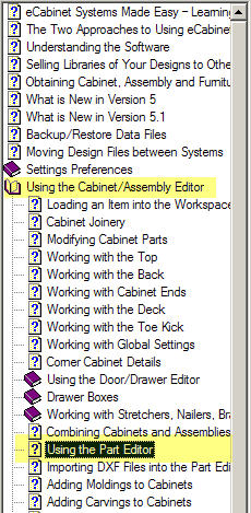

Look in eCabinet Systems Made Easy (on the help menu) and you will find instructions on making a turned corner post. You can use the same technique to make the Shaker pegs. The section you want is "Using the Cabinet/Assembly Editor -> Using the Part Editor." Double-click on the "Using the Cabinet/Assembly Editor" section to expand it.
The zipped attachment to this post is a jpg of the section that describes this method.
Part Editor.jpg (57.93 KiB) Viewed 10188 times
Turned Leg.zip
(195.89 KiB) Downloaded 781 times

Well, after about 4 hours of messin and cussin I figured it out. I will post them on the site in case anyone else is a crazy as me and wants them. Thanks for all your help! I'm goin to bed now!!!!

The crazy thing was, when I did it exactly as the help menu stated, it wouldn't work, kept getting error messages or it wouldn't do anything. Finally made my display cube bigger than I needed and it worked. Go figger..........
Re: Shaker Pegs
Tony,
When that happens reverse the feed of your tool or play with the offsets. Your tool was probably cutting too deep into the cube and if it cuts away all the cube you get an error. Or just make th cube bigger like you did.
